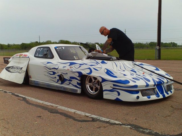

And I surely hope you’re being facetious with that pic. A full tube chassis car isn’t a GTR…it’s a GTR looking body on a chassis. We had Camaro and Corvette looking bodies for the turbo Pro Mod I used to crew on. Might as well say this is a real Corvette. 9374DE85-B22B-45EF-B583-0E93CA631529.jpeg
