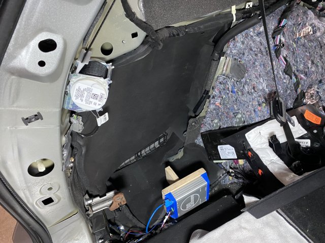

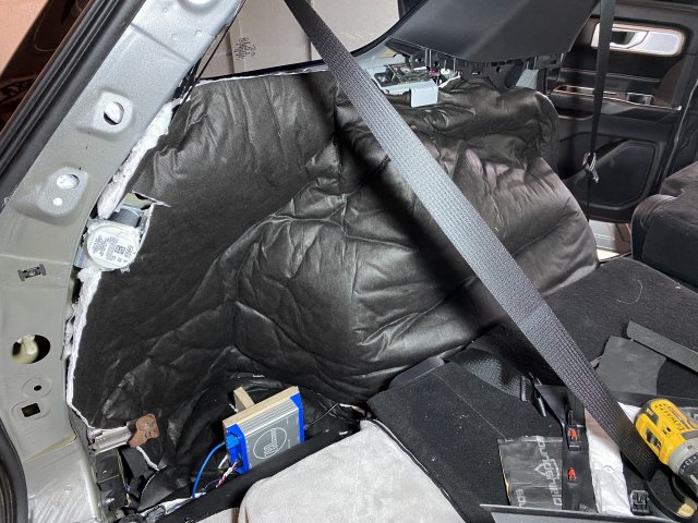

Sound and noise treatments are done…finally.
I filled all the large voids behind the rear panels with 1” closed cell rubber foam then covered everything with 1” Thinsulate. I didn’t get a pic but I also dropped the headliner again and put Thinsulate everywhere possible up there too as well as a layer of 1/4” Dynaliner from the back of the pano roof to the rear of the car. All of the AC ducting in the back is insulated with 1/8” Dynaliner…that air is COLD. 00C4CE0C-0C09-4655-A99F-8BAE0ED052FF.jpeg 5CE98816-DBD0-426C-8A8D-4421346613D7.jpeg 584FEFD0-4E51-4FA6-9400-4B2A51D65DE6.jpeg

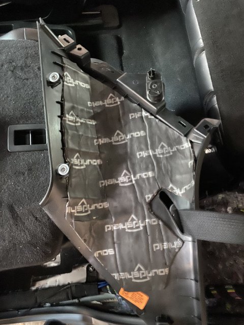

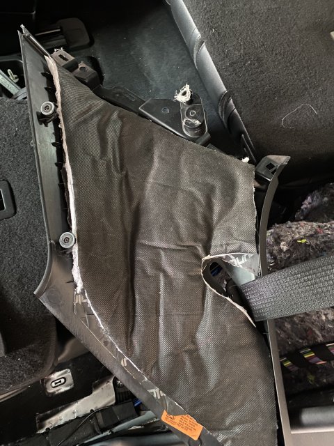

Every interior panel is deadened with CLD and covered with either a Dynaliner or Thinsulate depending on what I used. I had some Soundshield so I didn’t add any CCF to this panels …just Thinsulate D738B241-A213-4F1E-B0F1-6009E19F05AB.jpeg 810B7452-AFCD-4897-B7AC-ADF8920FBE5B.jpeg

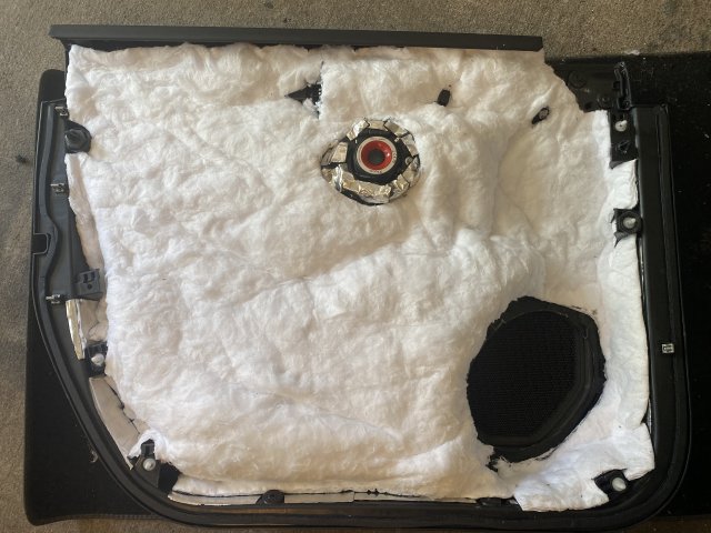

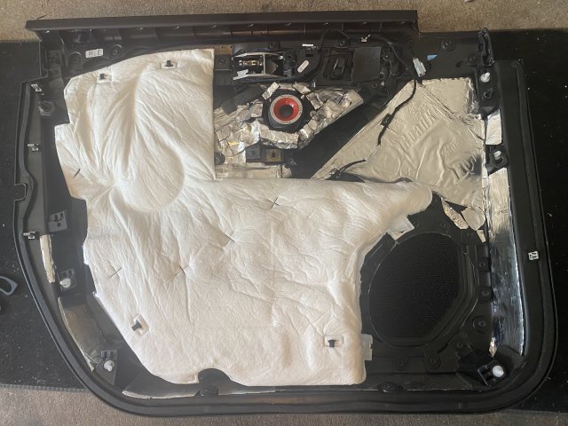

The door panels had some stuff on them already but it was poor coverage and the rear doors had very little…all are now 100% coverage with Thinsulate and heavily deadened with CLD. 83F9EEC0-C3A8-41A0-B656-A3D4365F06E3.jpeg A74A1DB6-6791-4705-9040-9077D68676C2.jpeg

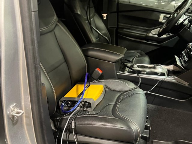

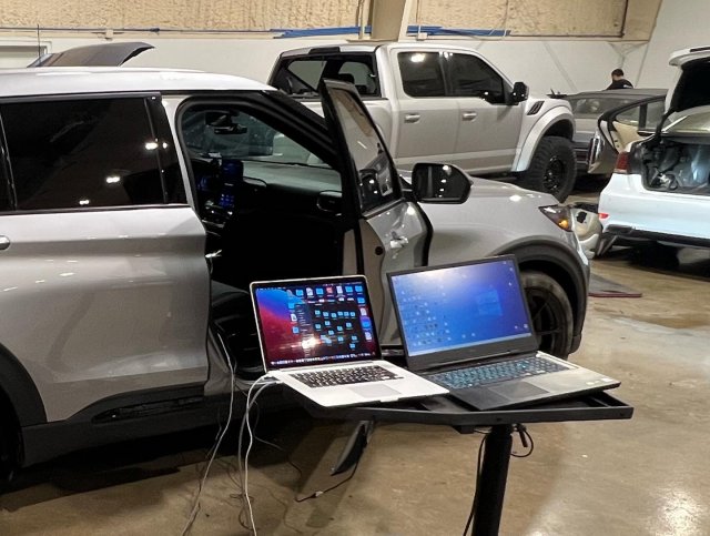

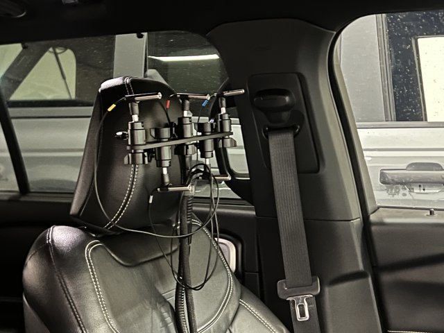

We’re doing the final round of tuning today at MTI Acoustics. I was here last Friday with Jeffery Hald, Christerfer Pate and Nick Wingate working on the tune and today we’re just fine tuning some phase alignment stuff. All tuning is being done via the JL Audio MAX tuning system with a 5 mic array.
Headed up to Dallas for SQOLOGY next weekend…which is the biggest SQ audio comp in Texas. I’m hoping it holds its own in my classes…guess we’ll find out in a few days. 348B91B5-93F9-4575-9F84-0C763D7D685F.jpeg EA9ABB70-F97F-4AB6-9E3A-ACCB275AFF45.jpeg 3DDA8E6B-BABB-4C6A-A086-DDE01E6B731B.jpeg

Damn nice microphone setup. As usual, I'm feeling a little inadequate with my one microphone and self tuning :LOL: Hoping to find somebody local that can do a final tune after I'm done butchering it.

This has been my first time seeing the JL MAX system used and it’s utterly amazing. Seeing phase alignments in real time is a game changer. We got it close last Friday…just putting the icing on the cake right now. It’s truly sounding amazing.
I don't doubt one bit it will sound amazing! My problem is I don't know if my beat down hearing could ever tell the difference between very good and great. I wis you were closer, I'd love to hear the finished product. Assuming I would say WOW but you never know until you hear it. Maybe I'll find a local club and see if I can listen at one of their street and greets. Heck I don't even know if I can tune it reasonably close. Tuner would probably laugh at me after I spent 30 hours tuning :LOL: The fun is in the learning though.

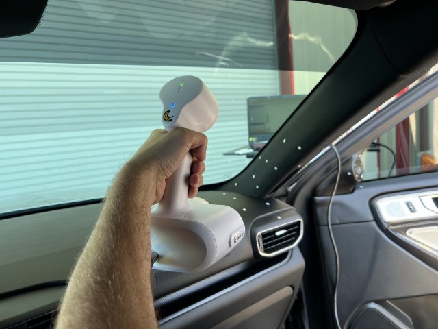

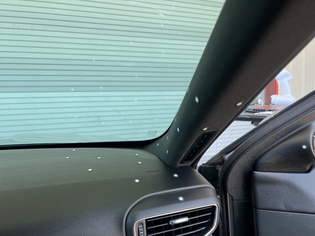

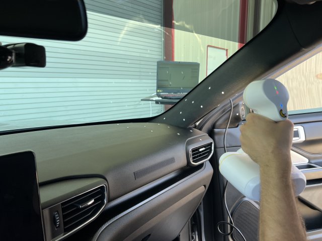

Cool new things coming soon. MTI is scanning the dash then they’ll model the midrange pods in CAD and 3D print them after. They’ll be covered in matching leather to finish them off. 3F487BA0-99C7-4435-B7F4-6B36C492B175.jpeg 262DAE7C-0D06-46EC-8D15-3C7BB4864D45.jpeg EB452D92-7F97-4541-9224-421B78BF70CD.jpeg
