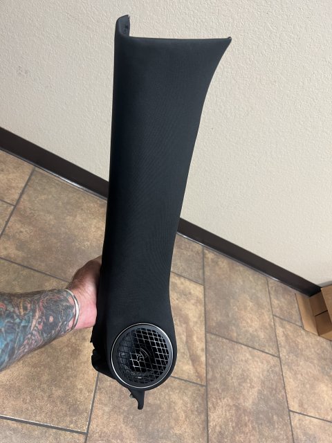

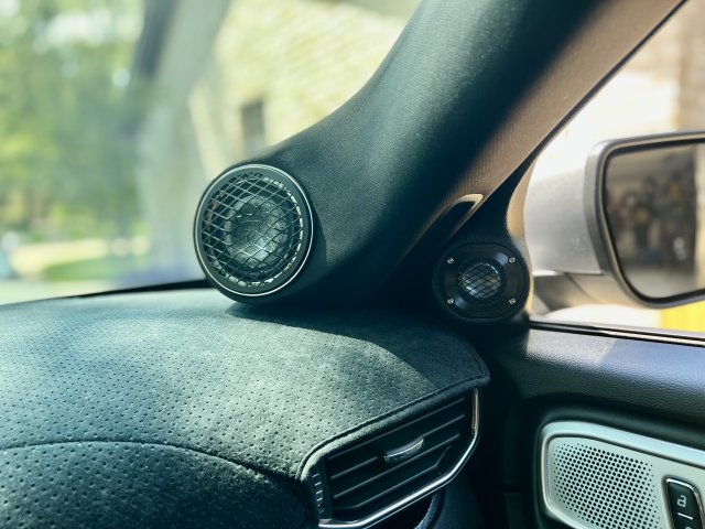

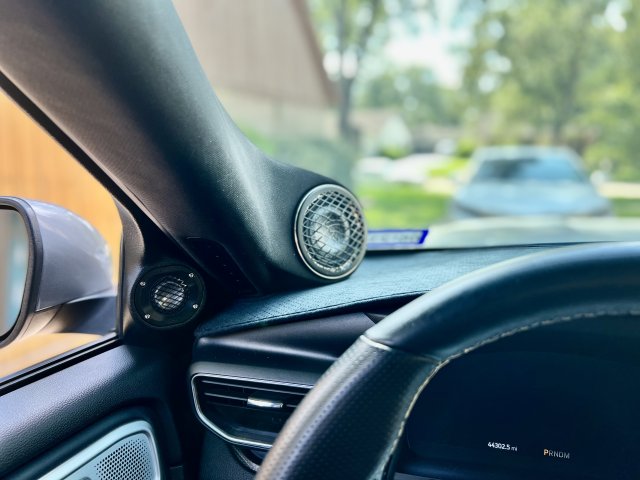

Pillars are complete. C637ED84-1BE5-4E75-A59C-E29424F8B1F7.jpeg 3DBEB270-D8DA-46CD-9E17-A932E5A11FD0.jpeg 200C7106-9925-4B61-BADB-8E6522A2998F.jpeg

The mid enclosure was 3D printed then epoxied to the oem pillar and blended in.

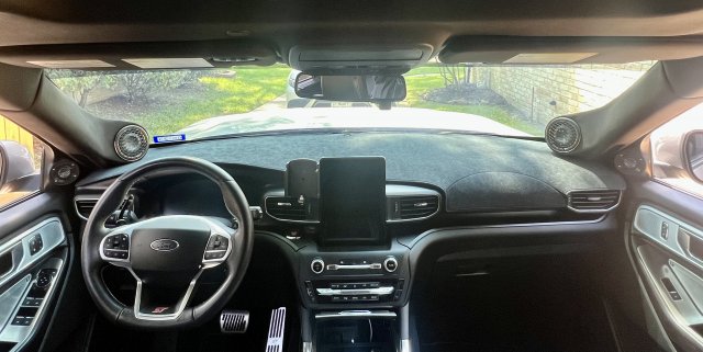

Excellent work … Nice looking Dash Matt would you mind sharing a link or the brand looks like it fits real well
I went through 3 others that fit like hell before I found this one. Dash Designs in the company. Sedona Suede is the material I went with.

Will it stay up and not slide around if you don’t use any of the adhesive crap they give with you the thing looks like it fits like a glove

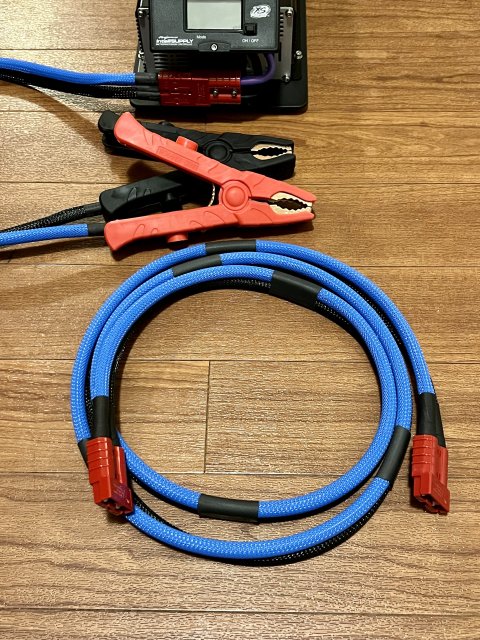

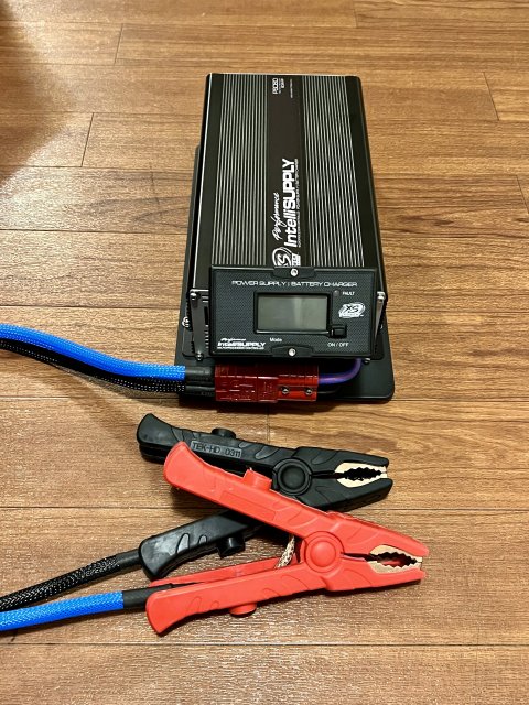

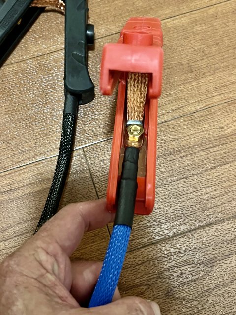

Finished up my power supply wiring while I’m out of town this week. Complete overkill with Stinger HPM 4 gauge all covered in TechFlex with 1000 amp dual live clamps. Made a short 3’ lead to hit my charging posts under the car with a 7' lead in case I need to extend it to a battery. 6CC4F69C-6364-49C6-874A-E74356C3C901.jpeg 2665DB51-04D2-445B-A071-99AA6CAA516D.jpeg 199437B6-FDBF-4946-BD4D-5E6FB07846B7.jpeg 91C0204E-D204-4170-8ADD-F863D34FE36F.jpeg

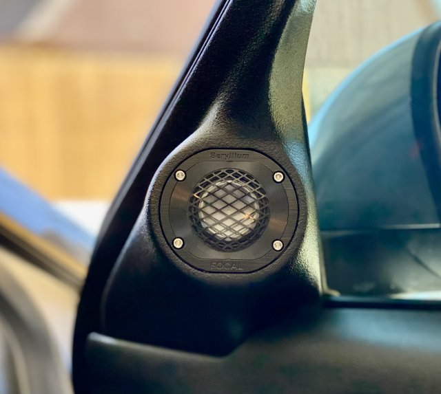

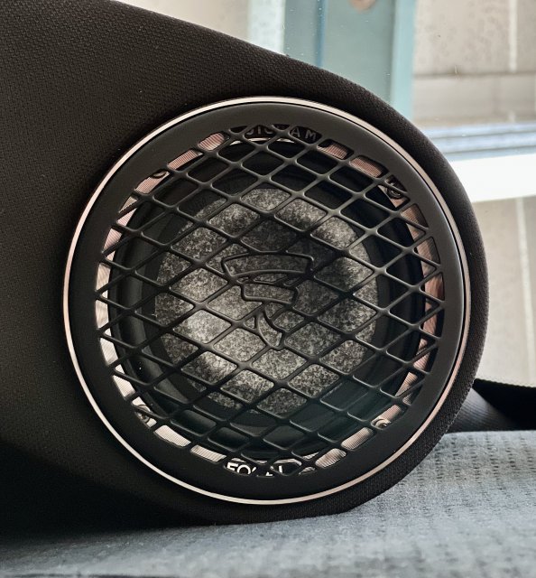

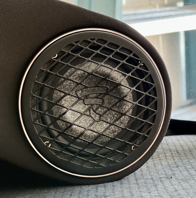

I highly disliked being able to see the silver part of the flange behind the grille…so I hand cut some neoprene rings to stick on and hide it for now. E982F287-B84A-4E36-A164-8E56C3100C8A.jpeg 8271F430-9E17-4AE0-97DA-B0F64FC63FBD.jpeg

What! No Sharpie pen on the silver fasteners? ;)
I don’t mind the screws showing. They match the tweeters that way…and all the visible screws in the system are Ti.

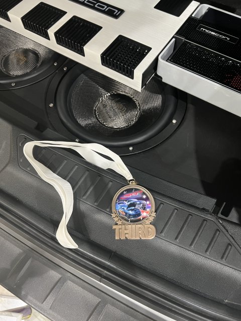

Went to the Car Audio Championship in Lebanon, MO this weekend just to see how it stacks up against the best of the best. Still have some work to do but overall I’m happy. 1st in IASCA Amateur and 3rd in MECA Modified for the 2023 kick off portions. Tied for 4th in MASQ Modified for 2022 Finals EB553D11-17F8-4656-94A2-0882B722553B.jpeg 659356E7-B9E1-4EF6-B97C-A473D1A761D6.jpeg
