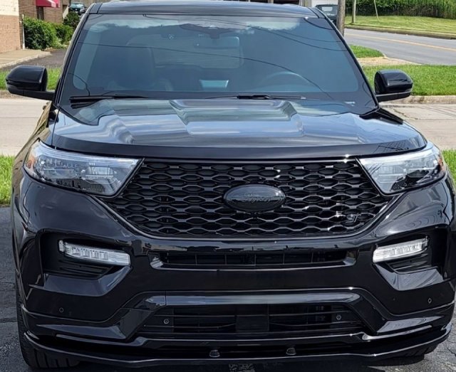

As clean as it looks without the lettering has anyone changed the color of them? Been tossing the idea of making them red but not for sure yet...

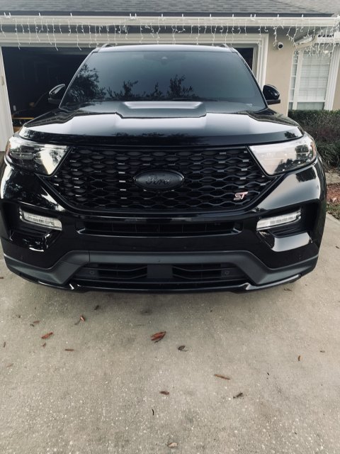

Just removed my EXPLORER lettering off the hood. Looks so much better and clean looking. Used fishing line and the 3M disc and really worked well. Took less than an hour.

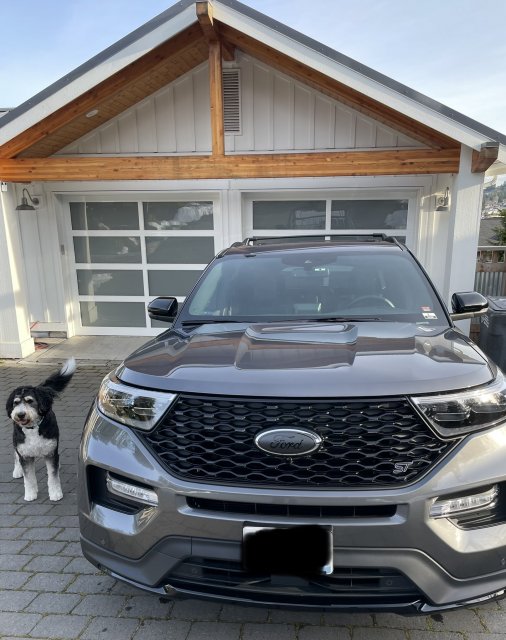

I took mine off today in preparation for a hood protector (not a bug deflector). Used dental floss to remove the letters, a plastic trim tool to remove the excess double stick material and finally Goo Gone and an old microfiber towel to remove the last of the sticky stuff. Finished up with Maguire's cleaner wax for protection until AMAZON delivers the Hood Protector next week.
Start to finish 30 minutes +/- a minute or two...
