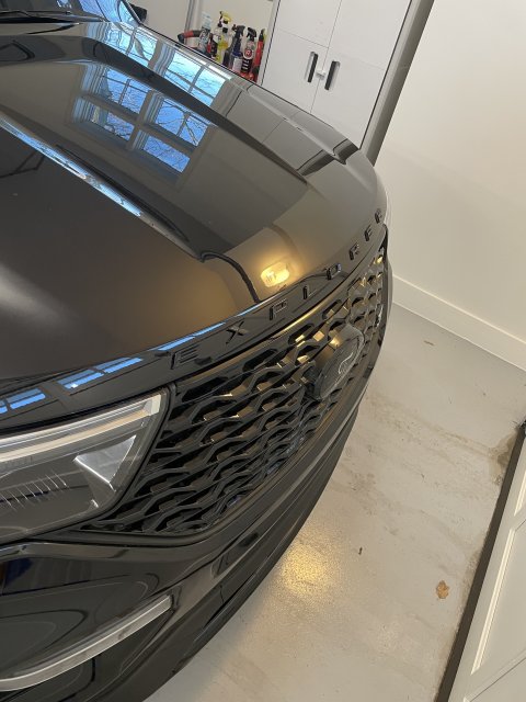

"EXPLORER" lettering on hood
172
101
Gig Harbor, WA, USA
How hard is it to take these letters off? Does it leave lots of adhesive on the paint? What's the easiest and safest way to remove them? Heat em up and pop em off??

Just slice them off with some fishing like or dental floss then remove the left over adhesive. I prefer and use a 3M Eraser Wheel because it’s done in a flash but GooGone works too...just a lot more elbow grease.

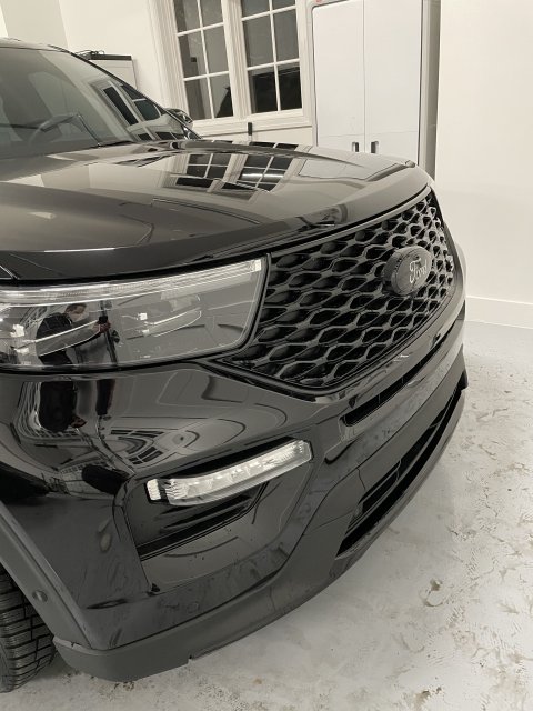

How's it look? I think its a much cleaner look for sure.
1,425
1,144
I’ll pull the letters on mine. No way I want to be cleaning bugs out of the lettering over the next few years.

It looks so much better off - i did this a few weeks ago using goo gone and it sucked lol - use the wheel

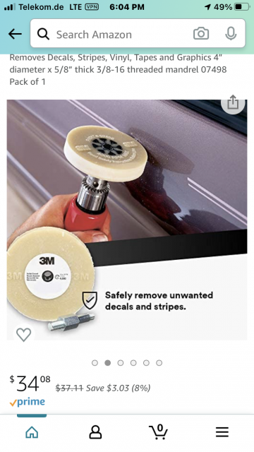

Is this the wheel you are referring too? Do you use it dry or with clay lube?

Much cleaner...thanks.

4,201
4,894
That’s it and you use it dry. O’Reilly keeps them for about the same price if you don’t wanna order and wait.

It took that long because you lubed the wheel. They’re designed to work dry...it would have taken you less than 2 minutes. lol
Yeah dry felt like I was gonna burn through the paint lmao
4,201
4,894
It won’t burn through the paint as long as you keep it moving and stay under 4000rpm. They were literally designed to work on paint, dry.
