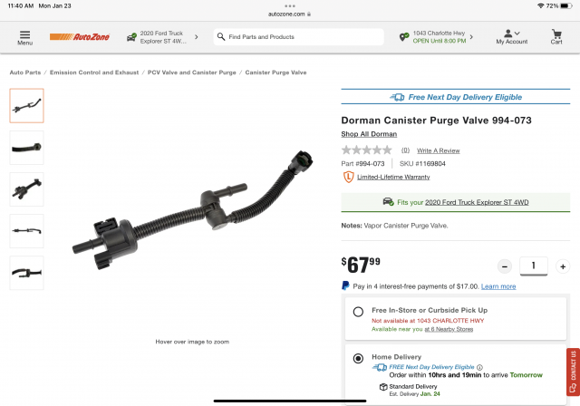

Every time I fill up my tank with gas my ST goes into “panic” mode! First off when I put the fuel nozzle in (no matter what level is already in the tank) there is a “puff” of vapors that is released. I then fill my tank and the car usually stalls (or if it is not running) doesn’t restart. I have to pump the pedal several times and prime the crap out of the engine to stay running. It runs fine once I get it primed and humming. Randomly it throws the EVAP code (which I clear with my OBD). Overall it runs ok but I do not want to go to dealer if this can be a simple fix. I purchased the EVAP purge valve (no diagrams online to show where it is) figuring that would rid the code and maybe the problem. Any ideas where it’s located (some say next to throttle body, some links say underneath…)?? Don’t think it’s fuel filter. Any and all help welcome. Thank you in advance.

Thanks for your help and post. Found it!! 2 of the 4 connections are very accessible…need some small hands with the other 2.

I don't think the evap purge valve is going to fix your issue. The purge valve is normally closed and the pcm turns it on to draw vapors from the fuel tank. If it were stuck open it would not allow pressure to build inside of the fuel tank and therefore you would not hear air pressure releasing when you put the fuel pump nozzle in. It sounds like you either have an evap canister vent valve that is stuck in the closed position or a plugged evap vent filter.

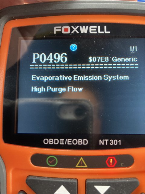

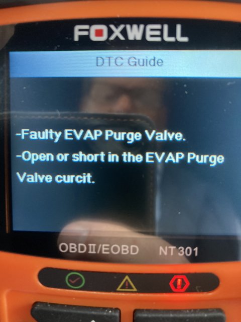

Just thought I would update my initial post regarding the EVAP issue I was having. Here is the OBD reading - was P0496 code showing issue with purge valve circuit. When you put this in search engine the canister purge valve part shows up. As stated earlier 2 of the 4 connections are very accessible while the other 2 in the back were a bit more challenging. I ended up removing 4 bolts (red arrows on pic below) that secured heating lines and was able to access the 2 other connections towards the back. All in all was not too difficult and was done in about 35 minutes.
