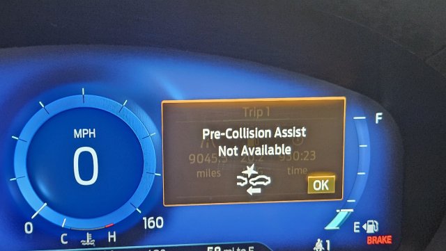

Hello All,
Not sure where to start for this error message. "Pre-Collision Assist not available."
Context: I had a V1 plug-in using one of those push-pin taps for power, inserted into the back of the camera plug rather than tapping directly into the wiring. The suction cups for the V1 failed, and it fell down and dangled by the wire. That is when the message appeared. I checked the plug going into the camera, and it was tight and secure. I then removed the V1.

It's not a visibility issue. The issue pops up as soon as I start the car.

Yes tried that and still get the message. The only thing I can think is when the radar detector fell, it shorted the camera or did something to un-calibrate it. Based on what I read, it can happen when windshields are replaced. Trying to avoid the dealership if I can fix it on my own.

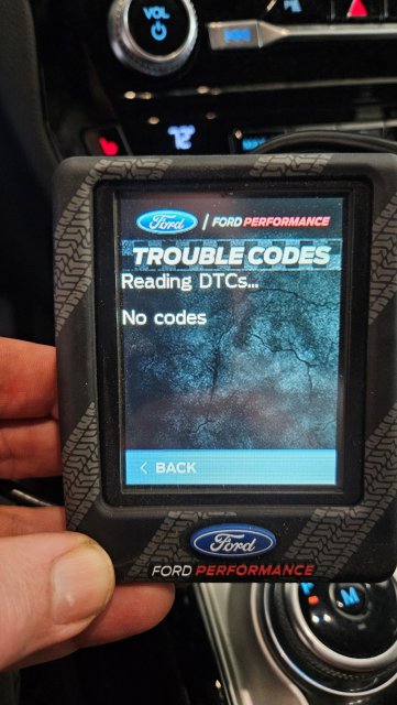

OK, so I unplugged the battery for 60 min then re-connected. The issue still happens.
My programmer shows no codes.
You are likely only reading ECU codes with that programmer. It won’t scan the other modules for DTCs, as that’s where the error is likely stored. If i had to guess it's probably in the BCM module.
Really need to scan with ForScan or a higher end scan tool that can read all module DTCs
