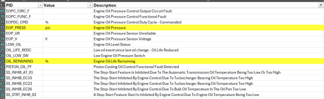

All of the oil related PIDs in the PCM, no temperature (except the one related to the auto start/stop)
Well, that looks like there are oil temp readings available for the ECU, but not output over OBD. Bummer.
