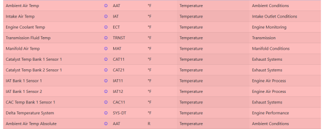

Does it show oil temp?
It does on some vehicles if it is being broadcasted via the OBD2 port (AKA - PID's). Ironically, I do not see engine oil temp as a PID from an Explorer. A display cannot relay and monitor info the vehicle is not putting out.
2025 Explorer iDash temp's display -
