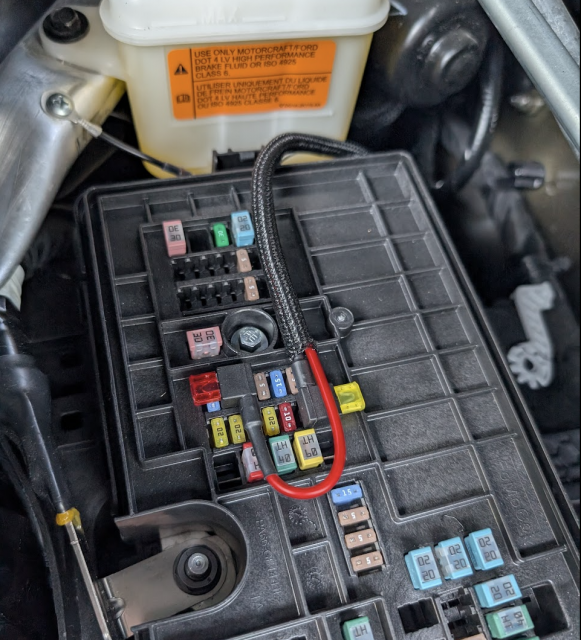

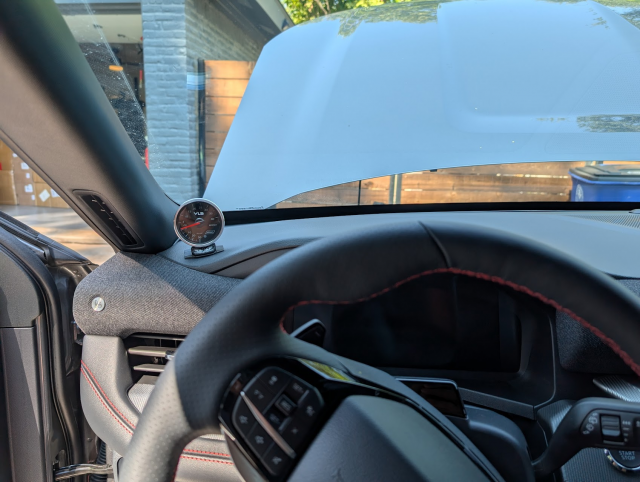

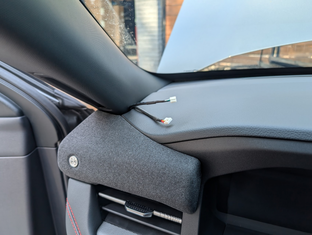

I grabbed constant 12v from fuse 70, which feeds the OBD2 connector.
I got key on power from fuse 54, which powers the heated steering wheel.
Made my own ground. Still haven't found an illumination wire yet. I will reroute and clean up the wiring when I do.
