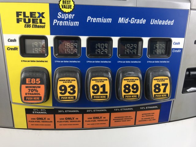

Yes its E30 - 93 octane per the pump markings. These are the pumps at the newer "Jumpstart" gas stations around Wichita, KS. This photo is about a year old and the E85 is now closer to $1.50 per gallon while the E30 dropped to $1.75 and then shot up to about $2.10 lately.

So I have the 93 Tune from ZFG. Based on the previous picture, E30 and 93 are the same fuel correct? Would I need my tune upgraded to specifically 93/E30 if I were to use that fuel? Is this better/faster than normal 93 with lower ethanol?
Thinking through it...This 93 would have less Energy content than regular 93(E10) and in theory you would need a tune specifically for it.
A Regular E30, a mix of E85 and 93(E10) would have an Octane rating that is higher than 93(E10) by itself, and also higher than the 93(E30) above. So while both would have the same E Content, the actual Octane Rating would be higher for E30(Mixed from E85 and regular 93/E10) than the 93(E30) above. I would have to do more Math to determine the theoretical difference in real world Octane...

Are they basically spiking 87(E10) with E85 to get the higher octane fuels? Probably to make it cheaper per specific octane rating but be less fuel efficient than 93(e10)
Yep!
