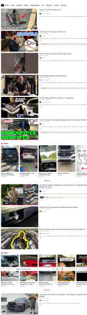

youtube is the best when it comes to this stuff.
