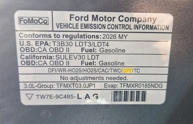

4/13/26 build date forward for 17 CARB-adopting states plus Washington D.C., including: California, Colorado, Connecticut, Delaware, Maine, Maryland, Massachusetts, Minnesota, Nevada, New Jersey, New Mexico, New York, Oregon, Pennsylvania, Rhode Island, Vermont, Virginia, and Washington.
Check the VECI sticker under the hood (it will list "GPF" if present)
Source: GROK

#36
I looked under my 26 and didn't see it. I don't know how to tell by the under hood sticker. Took delivery in February in Texas.
24
Towson, MD
2026 Explorer ST
#37
Look for GPF on the emissions sticker
