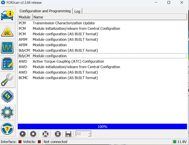

I am unable to find in FORScan where to access the FENG and ANC. Please help! Where do I go from here (attached pic of my stopping point)

What OBDII adapter are you using? You are showing about 1/3rd of the modules.

I still have this saved on my desktop from when I made the change. Check the last post from Road.racer
