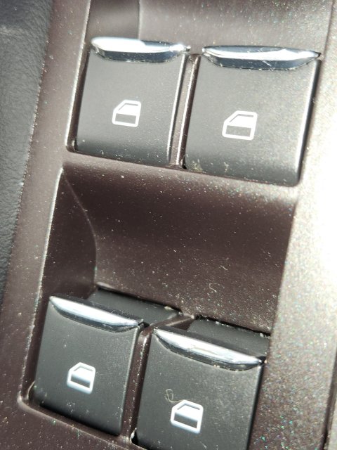

2. Window switches on drivers door peeling chrome.
(The window switches, one is started to peel already and 2 others are sharp and feels like it will peel soon.)

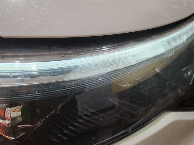

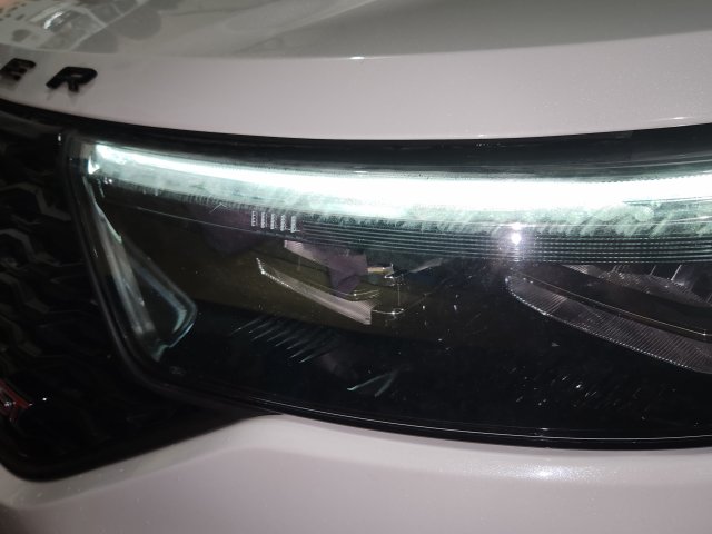

3. Headlight condensation
(Headlight condensation bothers me as it's just constantly damp in the Seattle area. So both headlights basically always has condensation after any drive over 15 minutes.)

Heated steering wheel and window switches should be warranty no problem. The headlights I guessing they will say it's normal. Have seen others with that and it wasn't warranty. The engine noise I have no idea. All you can do is ask them. If it's only on cold start that means you would need to leave it. Good luck.

2. (Driver door window switch chrome peeling) Replaced drivers door window switch module under warranty.
3. (Heeadlight condensation) Didn't ask for this to be looked at. Researched further and is normal and hasn't been an issue recently.
