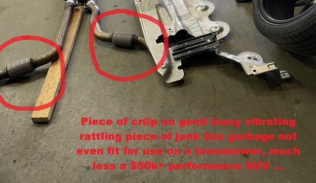

Anyhow. Started by getting the ST on a lift and removing the stock exhaust. Relatively simple since I've only hat it a few months. Good to have the manual or I would have not seen the bolt on the rearmost hangers that has to come out to get the rest of the back portion off.

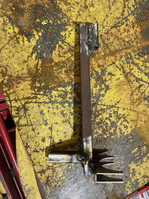

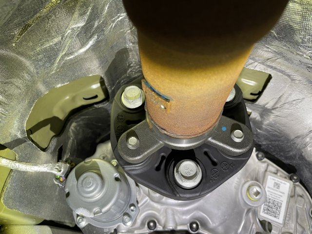

Ford shows you one of a few "special tools" one to remove the driveshaft from the diff. The Ford tool is a bar with a slide hammer that attached to the driveshaft. I made one from a 3.5" exhaust clamp and some square tubing I had lying around. Mind you, I weld for performance, not looks.....in other words I can get it done but it ain't pretty:D
To remove the driveshaft you have to remove 6 bolts from the coupler so you have enough room to pull the driveshaft forward. Be sure to mark the original orientation to you can install it the same way. Then remove the middle driveshaft support. Be careful not to articulate the driveshaft much as they say you can break it. I tied it up with coat hangers. to keep it supported and relatively safe. Then you just attach the tool to the rearward end of the driveshaft. There is a groove where the clamp goes. Once you tighten it down you pound on it a few times ans she pops out. Remove and set aside so it doesn't get moves.

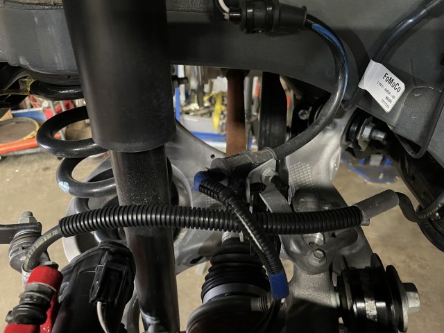

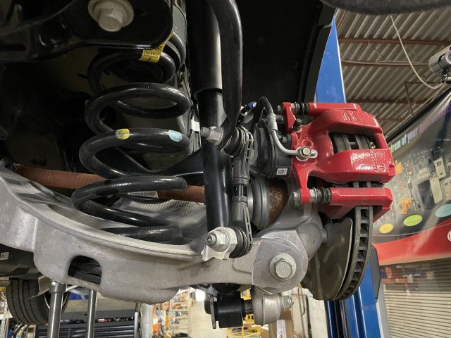

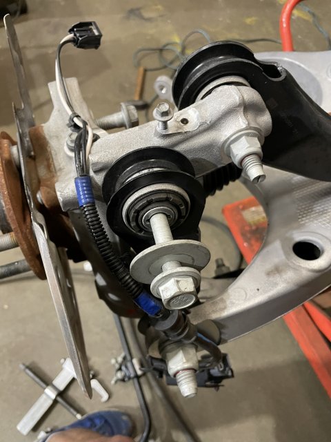

Next step is to disconnect electrical harness to each wheel and hang each caliper from the body. You don't want the calipers hanging on the hose. I used some S hooks to hold them.
Also need to remove the clips for the diff vent. and disconnect the lower rear stabilizer bar links and remove the rear stabilizer.
Also remove both lower shock bolts.

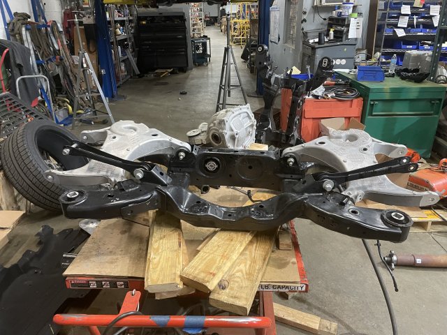

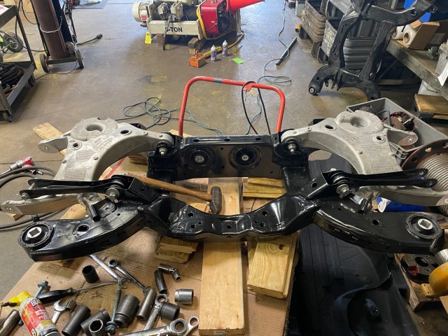

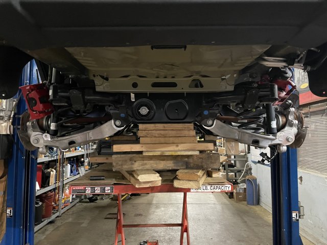

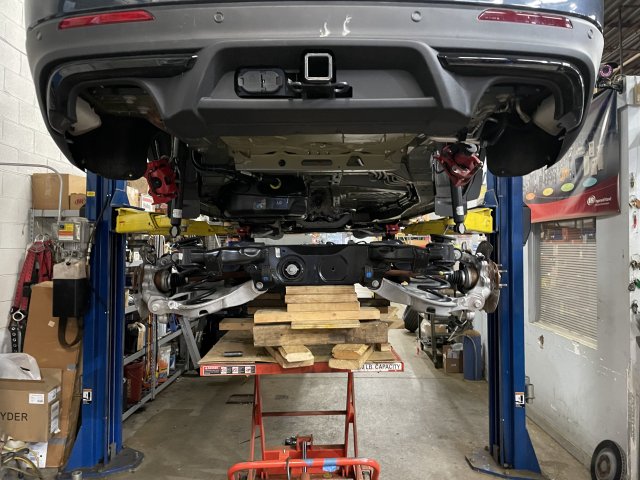

Now comes the fun part. Fortunately I own a tool company so I have nice tools like this lift table.

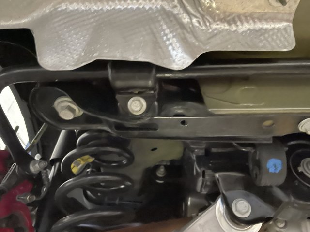

Basically support the rear subframe bu the subframe only, not the lower control arms but the subframe itself. Build a little support for the whole shebang.

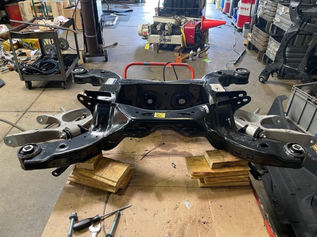

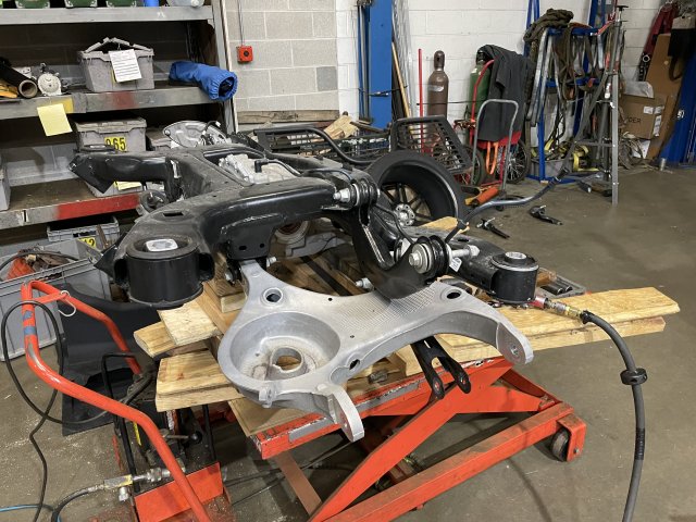

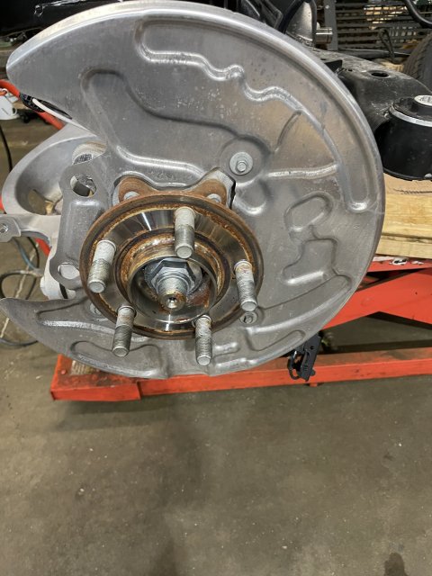

Once it is at ground level it is much easier to work on. The good news it the Steeda springs and swaybar will take about 30 seconds to install once I'm putting it back together.
Removing the knuckle is a minor PITA. Four bolts on the back, remove the big bearing nut, and use a puller to drive the driveshaft our of the knuckle.
Some more progress pics.

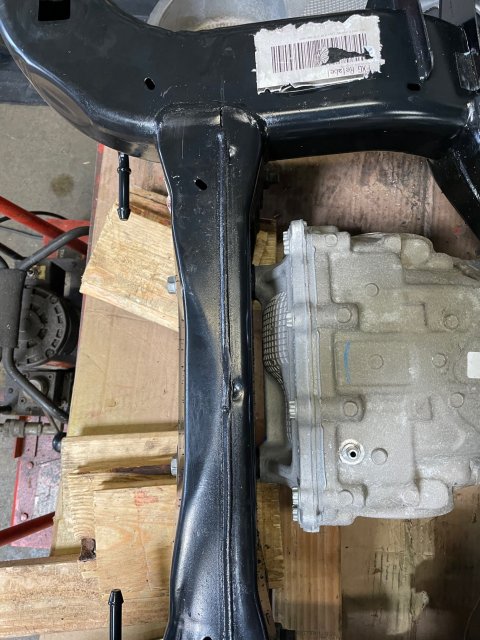

My only comment comes from this pic he posted ...

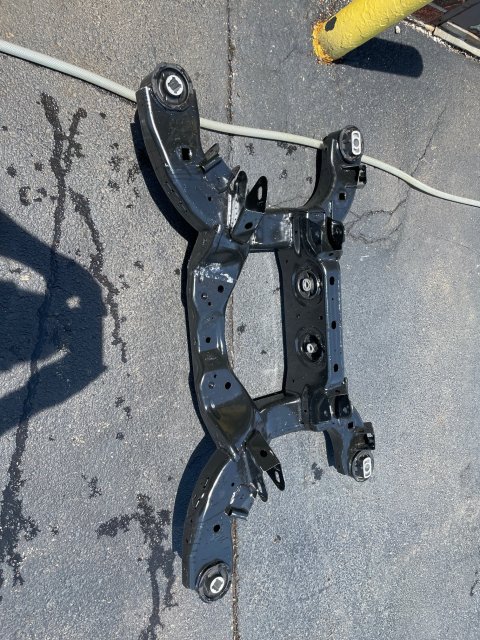

After a day of sleep I figured I would post some updates.
Starting Sunday with a crossmember with only lower control arms. Got that stripped then washed the new crossmember (not sure why) and got ready to see how much I forgot taking it apart.
