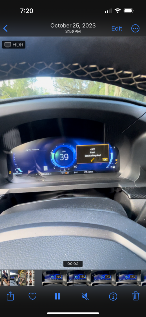

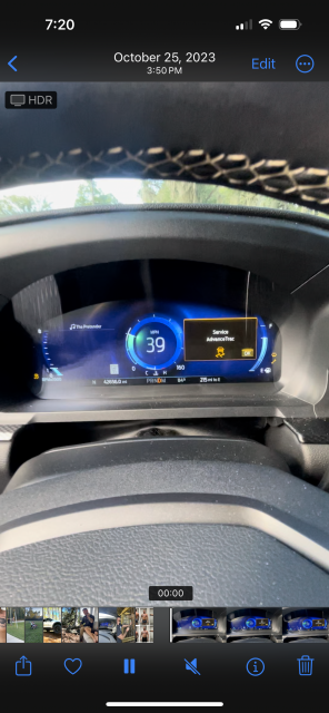

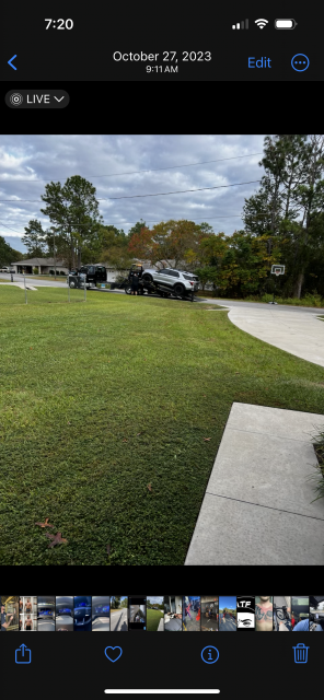

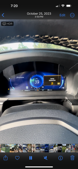

Please tell me what happened-
Please tell me what happened-[/QUOTE
confused Christmas tree dash
Power loss
Slight tick
Then a hard knock
Then limp mode
Full motor replacement covered under warranty
