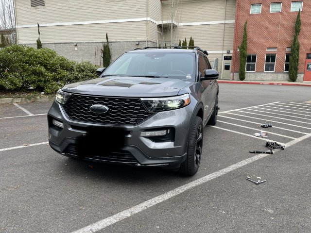

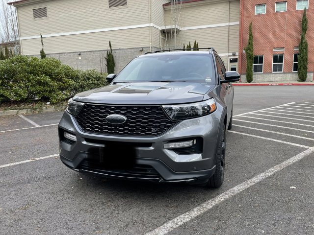

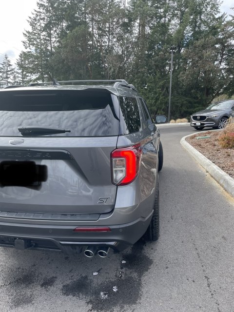

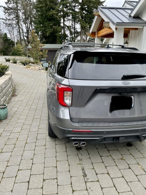

If anyone is interested. Stock wheels and springs with Bora spacers 1.25in front and back.

I haven’t driven it on winding roads yet. But it seems more stable. Definitely looks better

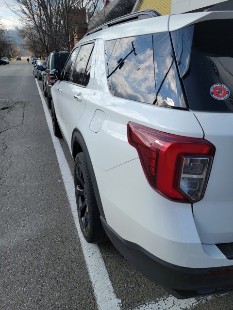

Did you have to cut the studs? Also, did you install the factory lugs to secure the spacers to the factory studs, then aftermarket lugs to the spacer studs?
Kirk ST
120
Pittsburgh, PA, USA

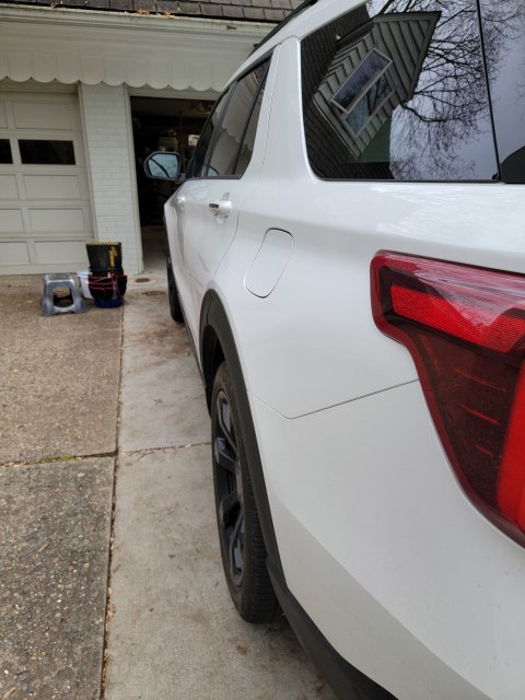

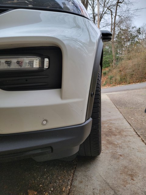

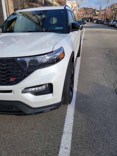

Hi all - on a warm Christmas eve afternoon I put on my 1" front and 1.25" rear Borla spacers. I did have to trim down the front studs about .25". The rear stud length wasn't an issue at all. I had an angle grinder with a cutting disc that made short work of the front ones. I definitely like the look a lot more and I think I can feel the handling difference, but it might all be in my head! If nothing else, it looks much better AND it was a good reason to take the wheels off and do a good cleaning on the inside of those rims. My spacers only took about 3 weeks to get to me. The whole job took about 90mins once I realized I had to trim those front studs. Here are a few photos: 2 before, 2 after.
