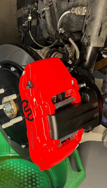

hey can you take a pic of the rear caliper parking brake?? i'm having trouble getting out of parking brake maintenece mode?? i'm wondering if mine are oriented and connected properly??
how did you enter and exit service mode?

ugh all I have is forscan and it’s not doing the trick! I would hate to have to limp over to the dealership stuck in maintenance mode. Sent you some images in a message on here can you confirm if I have the driver side rear installed properly as far as the EPB actuator with the connector positioned toward the top of the caliper?

#36
That looks right to me. I did have a heck of a time getting the connector to click and lock on the ebrake. Had to use pliers to get them tight enough to lock.
Ended up being one of the new actuators was DOA. I ended up using the original ford rear caliper electronic parking brake actuators and putting them onto the Superforged rear calipers and everything worked! I avoided needing to use their wiring harness and actuators all together this way!
