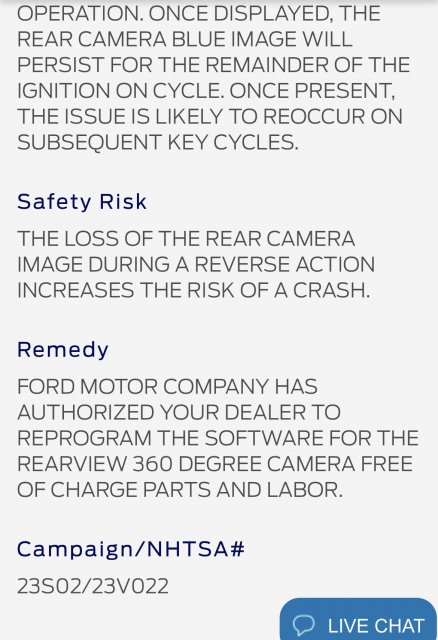

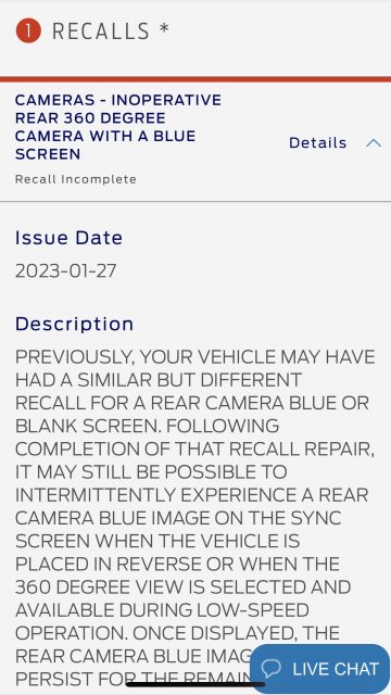

So I just received the recall notice for the camera has anyone else?
6EE7B4D1-1FA0-4541-B2CE-C8E756A39C61.jpeg 51C22ADB-8F31-4AF4-8F24-EBDA70580999.jpeg
137
54
New York
2022 Ford Explorer, ST
Waiting for my notice…. I better get it. Still having that issue all the damn time.
My Ford pass mobile app doesn’t show the notice. I logged into ford.com and went to my account and that’s where it shows the recall.
