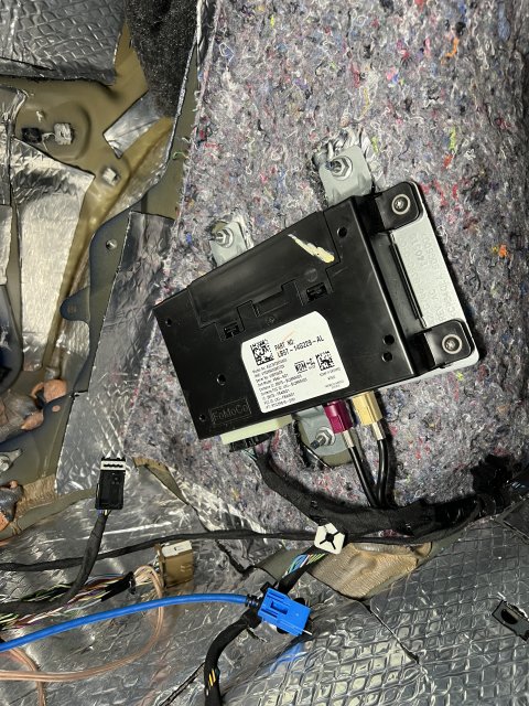

is it a problem to cover electronics with the Thinsulate? I don’t want to start a fire lol. I’m mainly thinking about this thing in the driver side rear wheel arch:

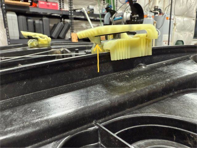

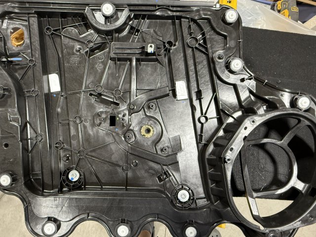

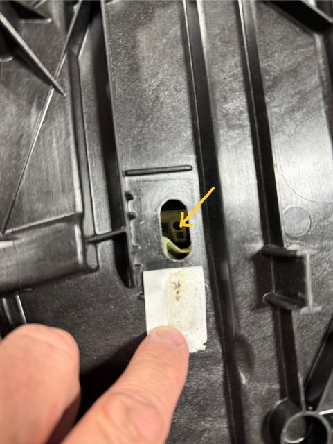

To remove the window regulator you have to GENTLY push the tabs out of the holes in the brackets attached to the bottom of window glass. The white tracks do not come off. I broke one of the white tabs and had to buy a whole new window regulator which is that entire plastic black panel attached to the door.

The tabs don’t come off. Here are some pics of the regulator I broke.
regulator from the front. The two pieces of white tape need to be peeled back to access the window tabs for release.
Here is a closeup of the tab you need to GENTLY push in to release from the window.
here is the backside of the regulator
here is a view of the tab you push to release the glass. Push too hard or too far and you will snap the brittle plastic on the arms.
After you reinstall the regulator, you just lower the glass back down and it will click back into the tabs.
man!that's awesome that you took lots of pics. I really appreciate you sharing your pics & your experience & your time overall. Truly grateful.
