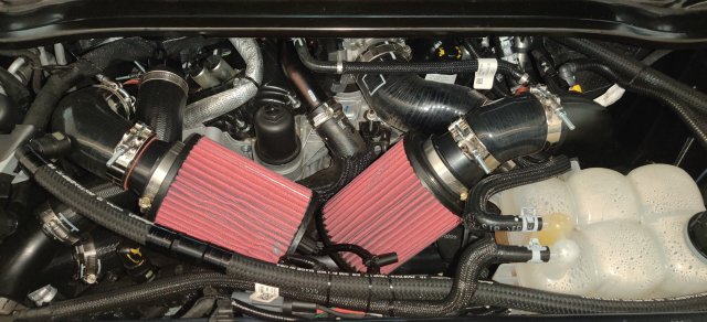

I’d bet money the hot air those filters ingest will negate any possible benefits from the additional flow.
Maybe log IAT’s with those and throw the box back on to log them again…my guess is you’re doing more harm than good.
Nope, pre IC temp doesn't really matter and it's in front of the fan that blows air over it, snorkel is still functional.
I am looking at iat2 and Whipple IC does a good job.

Yeah, my head says that just ain't so. An intercooler can only remove "X" amount of heat. It doesn't simply bring any charge down to a given temp regardless of the inlet temperature. I'm with UNBROKEN on this one. I'd bet dimes to donuts your inlet temp is higher using this set up than in the OE box. That said, you likely could flow more air assuming the engine needs it. I'm a believer that until you start doing significant mods, the OE box can provide enough air for minor mods.

We can easily just do a bit of math. Let's assume the Whipple is 80% efficient (I don't know actual numbers). So just for grins, (and to make the math a bit easier), let's assume 100 degrees ambient. Since PV=nRT, and we'll also assume an 80% efficient compressor (it isn't), if we double the boost pressure we should roughly double the temp out of the compressor, except since the turbo isn't 100% efficient, temps would increase to approx 1.2 * 200 degrees (double input temp), or 240. The difference between that and ambient is 140 degrees. .80 (intercooler efficiency) * 140 = 112 which means intercooler out would be approx 240 - 112 or 128. Now doing the same exercise, but assuming input to the turbo is underhood air at thermostat temp or 180. Now temp out of turbo is 360 * 1.2 or 432. Factoring in the intercooler again diff is 332 * .8 = 266. 432 - 266 = 166.
Now, it's late and I've greatly simplified everything, but it definitely shows that input temps definitely have an impact on temps out of the intercooler. And no, I didn't take into account heat soak or the fact that the input temp of @CrankyPants might not be at 180.
Math...it's a beautiful thing.
Ideal Gas Law FTW!!!! This guy has another thread about knock when accelerating after stopping. Hot inlet air temps will tend to cause knock and then your engine pulls timing.
100-120 is hot iat when stopped?
Have you seen the oats with stock IC?
Not says box woul not help, but haven't had time to make it yet.
Assum it'll drop another 10+ degree on a hot day.
Problem is, the under hood heat has nowhere to go, wented hood would do wonders.
And people say you’ll never use this stuff in real life. This is gold!

No, opening this air box will not give you more power. DP and / or IC will be a much better dollar per gain than an intake on this platform, especially if you are on stock turbo and fuel system. Just drop in a high flow filter.

Did this.
Stock air box is tiny and restricts a lot of flow and both intake sides fight over one area.

Did this.
I dig the set up. Everyone is gonna have a negative opinion on this. Not sure why, there are similar set ups like this on alot of builds cars out there. BMW's, Nissans, etc. Rock on with ya bad self.
Everyone had a negative opinion because it’s a demonstrably bad idea on this car. Underhood temps are higher than I’ve ever seen…open filters sitting on one of the hottest places under the hood is not a good idea…period.

People that think open filters sitting on top of this motor are a good idea probably also think there are more than 2 genders.
