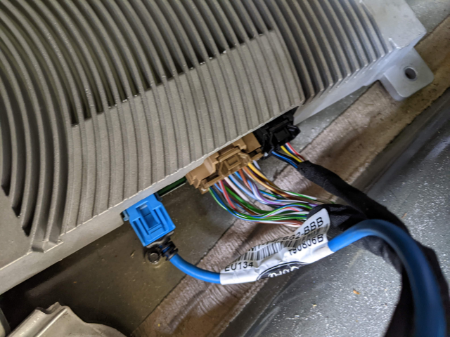

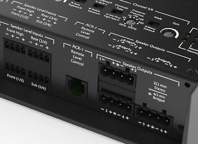

I am finally getting around to upgrading my audio system. I have the premium tech package with the subwoofer and all that. I am thinking of purchasing a LC-6.1200 so I can power 2 sets of speakers and install an aftermarket subwoofer as well all in the same package. I just pulled apart the back of my vehicle to see what I am dealing with and was hoping to get some help on a few things.
Does anyone have a wiring diagram? I need the speaker level inputs for front and back speakers.
Are the speaker level inputs going into the amp on the back side of the oem subwoofer or do I need to find them somewhere else?
Is there a remote power-on cable anywhere in the back left section?
B

Here is a photo of the amplifier. I need speaker level inputs for my new amplifier. I am hoping those are in the bunch of colored wires? 1685548002257.png

He’s looking at an amp with speaker level inputs so he won’t need an interface. It’s far from ideal but it will make sound. It’s no different than wiring in a line level converter like an LC2i.

Do you still need the pinouts for those connectors? 12 or 14 speaker system?
Yeah, I'm still looking to get the pinout of the connectors on the amp side. If you also have it on the radio/headunit side as well, that would be even better! 14 speaker system.

Thanks @Stone17!
I think I might go with the PAC AmpPro instead of jumping in off the factory amp. This should still be very helpful so I know which wires are which.
