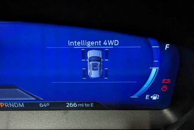

Try adding Intelligent 4WD to your display screen. That way you see how much power is being sent to the front and rear wheels. You could try switching it in and out of slippery mode also. That mode sends the most power to the front wheels.

Thanks for the help but I’ve already tried that. When the lights went out and I could switch driving modes, I tried Slippery mode as well as Trail mode but it didn’t work. Even in Normal mode I can see power going to the front wheels when I have Intelligent 4WD up.
