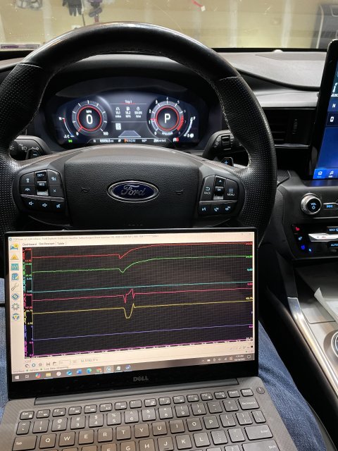

For a 2020 Platinum my mother owns I'm trying to diagnose the following codes: U102F, U0102, U0146, U011D, U0100, and U0418 pulled using FORScan.
These codes are accompanied by the following messages in the cluster "4WD Fault Service Required," "Hill Start Assist Not Available," "Service Advance Trac," "Pre-Collision Assist Not Available," and "Reverse Brake Assist Not Available See Manual" (when shifted into reverse).

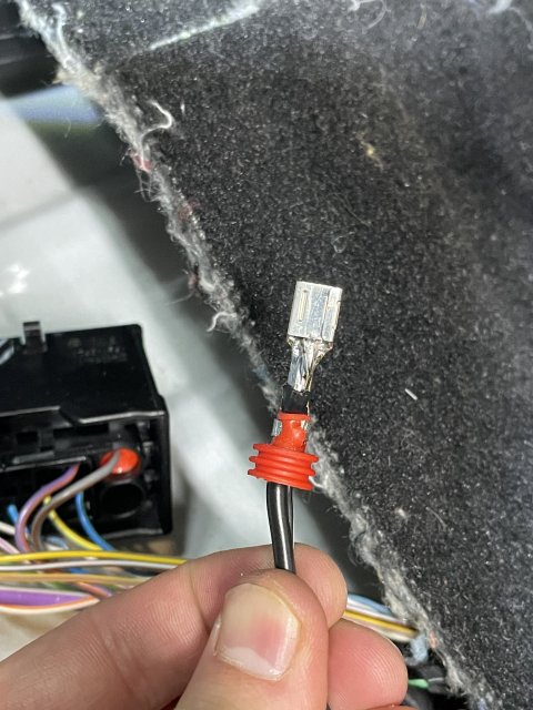

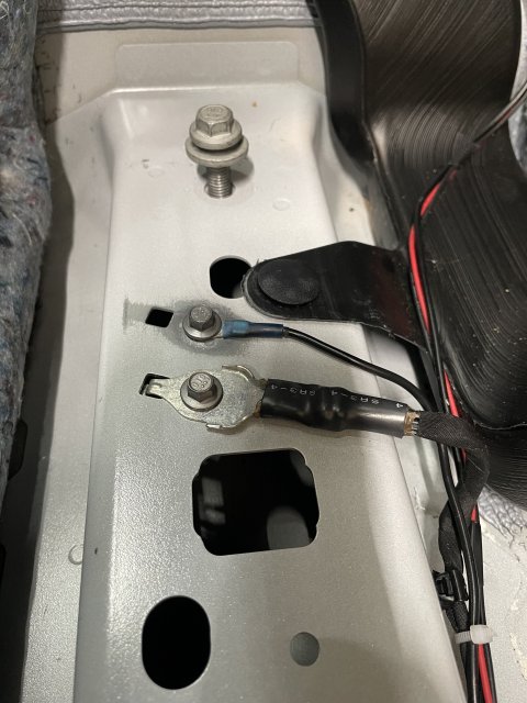

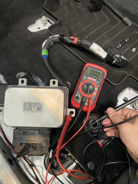

BTW i fully verified this was my issue. I was detecting 50Ohms between the AWD module case and ground. I was reading 2.3 volts from the ground wire at the FADA connector to the engine block. I wiggled the connector under the driver seat going to the AWD module and all of the grounds cleared up and all of my DTCs and dash lights went away. I'm going to perform the TSB so it doesn't come back but man i'm glad you shared this.
BTW this TSB does not exist anywhere anymore. It has been removed from Ford's database. I called ford and asked them about it, they say they have no record of it. I emailed the TSB to them and the guys was pretty surprised he said they can't find it anywhere. My best guess is that they have an updated AWD module that no longer has the ground short issue and they expect you to just replace the AWD module with the new module. But for 300$ module plus 2 hrs of labor plus programming. That's a big job when some 16 awg wire, crimp, and a ring terminal can to the job for pennies at home.

I added a good ground to the AWD module and all of my codes went away and the car is back to normal.
