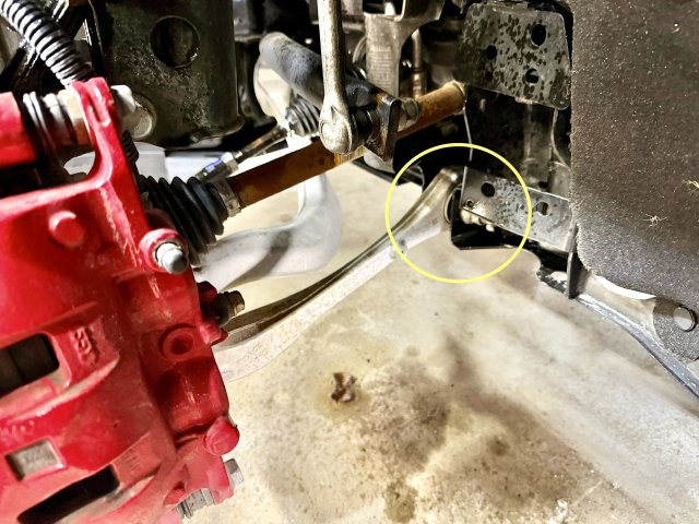

So did some more trouble shooting today. I previously replaced the front end link with an old one that seemed still in good shape. Still got the occasional popping. Today i tried to tighten every nut and bolt in the suspension and subframe that I didn't try on my previous go-around. Lo and behold, I found one!! It was not so loose that I could turn it by hand but with a wrench i tighted it about 1 1/2 revolutions. Rear lower control arm nut as shown in the picture. Popping noise is gone! Maybe this will help someone. To recap, this is a 5 mo old 2026 ST and the popping noise just started a couple of weeks ago.

#45

#46
