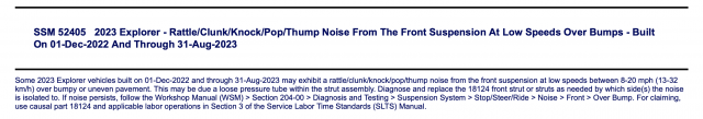

Finally after 2 weeks, I got my Explorer back with new struts this evening right at closing.
No clunking or popping so we will see how many miles I can go before it strikes again. Hopefully this fixed the issue.
UPDATE*** after a day of driving the clunking sound has returned on the new struts!
Waiting to hear back from dealership on rescheduling….

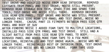

#38
work order:
Rudy2025
