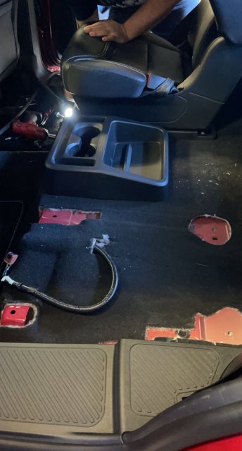

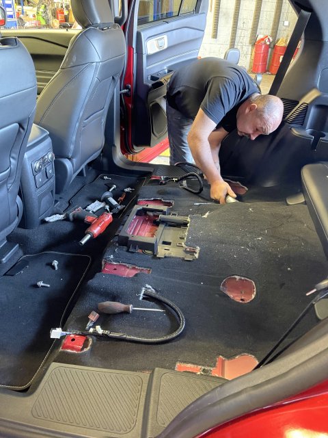

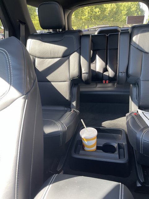

following up with my previous post I installed the cupholder console on my 2022 explorer st, I just ordered the bracket and cupholder from ford off of a 2020 explorer st. there are holes still under the carpet they just have tape over them, Just remove the two back seats and make sure to cut the carpet correctly for the bracket.

I just did it over the weekend and there are holes there, just purchase the bracket and console from a 2020 explorer st, I believe with the bracket, console and hardware was around 150 bucks, I just used my ford pass points.

Pretty cool! While that seems like an awful amount of work for some extra plastic cupholders but love to see people go the extra level and make it there own. Good work.
Is removal of the rear seats necessary for removal of the console? I would like to remove mine so our dog can lay there and put down some all season mats over the carpet. Would the rear seats need to come out to remove the brackets?
Boise, ID, USA
YES, and if you do there will hardly be any carpet underneath and the flooring will be exposed

keep in mind that if you add the center console that you will lose access to the back seats. the middle captains chairs only move so far forward. they do not fold up for access. I guess you could step over it but that could be a PITA...LOL
