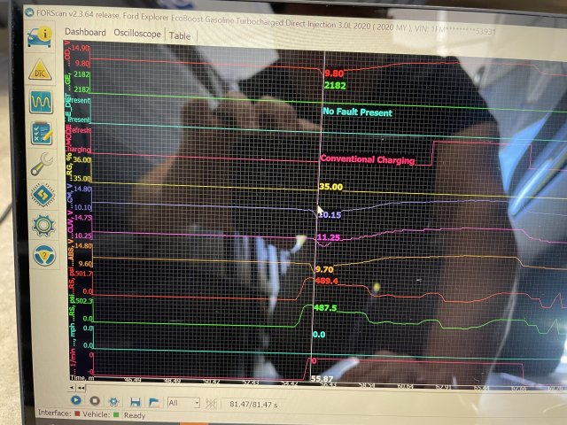

I replaced the battery and it didn’t fix any of the communication errors. I actually got to the root cause. The ground on my AWD module is failing intermittently. I verified it with a multimeter and looking at the oscilloscope on forscan. I have a whole thread about it in case anyone else sees these posts.

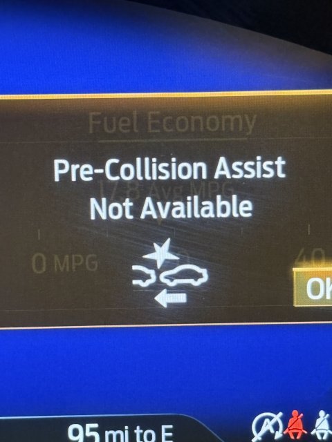

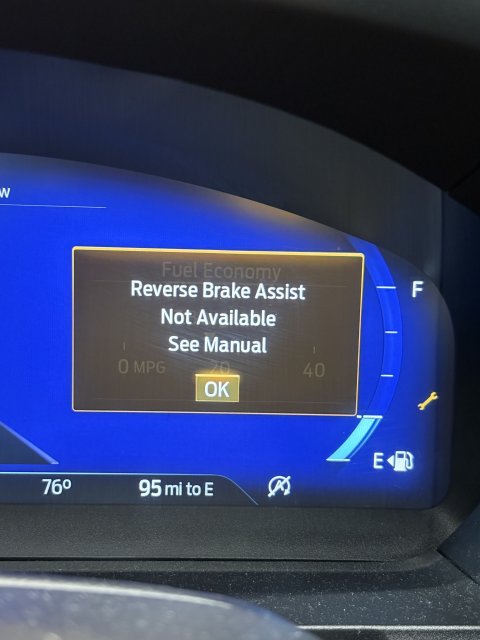

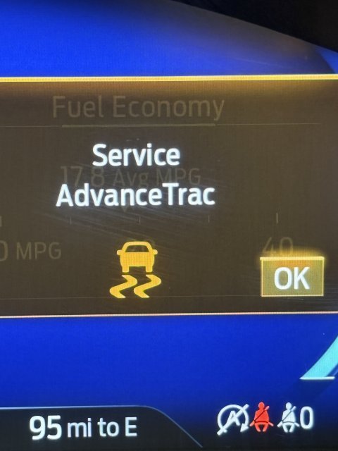

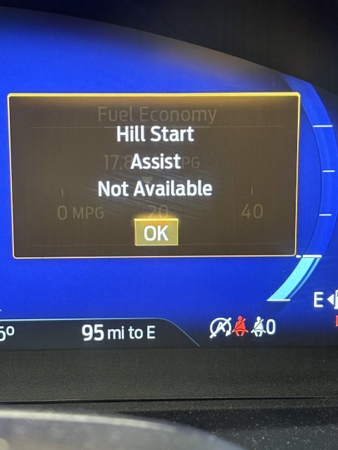

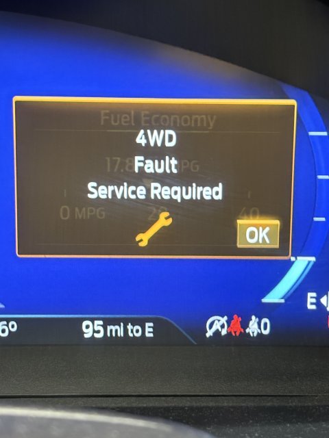

I think lots of short drives with auto start/stop can drain the battery. With a new battery these warning from the ford app about preserving battery and disabling features went away. The other warnings i mentioned on the dash about awd stuff were all a ground issue at the AWD module
