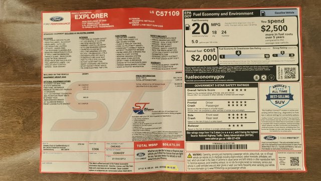

reposting for convenience -
Here is where to find the build date for Explorer on window sticker, below the MSRP -
W
80
30
Philadelphia
Production dates are on the driver side factory door sticker too
