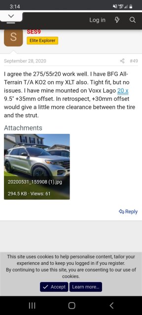

I'm looking to do a 20" wheel/tire setup with all terrain BFG K02 tires. From researching other threads it looks like the best size is 275/55/20. I want the setup to be just a few mm wider than the edge of the fender. I'll likely be getting BC Forged wheels with custom offsets front/rear to achieve this look on all 4 corners. My best guess to get this look is 20x9.5 et25 front and et18 rear.
Looking to see if anybody can help me figure out if this is accurate or if they have other suggestions and also would love confirmation this will fit my spec/no rubbing issues etc.

I think you just gotta be under 32” to clear but man that size is literally almost at 32” and I have never heard of anybody going that high in diameter. My set up is going to be 31.3 or something which is 285/50r20

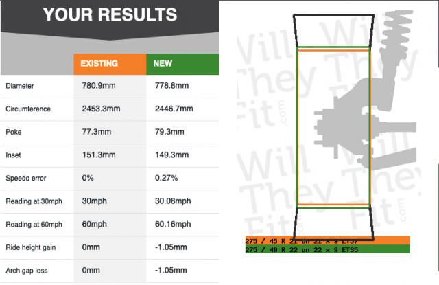

Here you go. You need a overall tire diameter of 30.7". To maintain the same amount of tire ratio or bulge you will need to run 275/40r22 tires in the front and 315/35r22 tires in the rear--otherwise it will look funny (a 275 tire installed on a 9" and a 10.5" wheel looks VERY different) or be the wrong diamter (in a AWD vehicle that's very bad).
in the front, this is the comparison between a stock 275/45r21(21x9+37.5) street pack wheel/tire setup and a 275/40r22+35 (22x9+35). as you can see, almost perfect with just a smidge more poke.
in the rear, this is your comparison between a stock 275/45r21 (21x9+37.5) street pack wheel and a 315/35r22 (22x10.5+30). as you can see they poke out about 1" more. Thats alot and probably more than you want to do. That would give you a 2" wider track in the rear than the front. The front has a 1" wider track OEM so its not the end of the world but its something to think about. you can do 1 of 3 things with these facebook wheels to make them work.
a) run 1" spacers in the front (not a fan as 1" spacers might require stud cutting depending on the size of the pockets on the aftermarket wheels)
b) run 1.25" spacers in the front (works perfect but now your front track width is .5" wider than the rear--OEM is 1", so no biggie here)
c) run 1.25" spacers in the front and 0.25" spacers in the rear for a square setup.
If you need clarification on any of this, just let me know. Good Luck!
