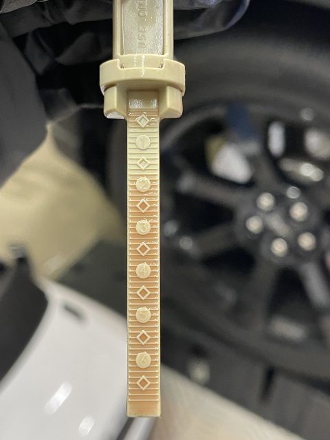

I got the trans up to temp and got a level at 4. Should I add a half quart? View attachment 31657
How did you verify the trans temp? If you used a scan tool and read 195+f then yes,

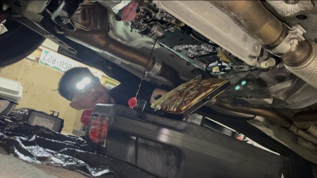

Definitely add more. But it took me almost 20 whole minutes of decently spirited driving to get it up to 195f. Start with half quart and check again. Up to the 2.5 mark is preferred. Also your fluid looks brown like mine did before the change. You should consider dropping the pan and putting a fresh filter in. Attached a pic of my fluid after the change. Looks a lot more clean

Yes my accessport gives a trans temp reading. I spent over twenty minutes driving. I’m at 55k now and will probably drop the pan at 60k or so.

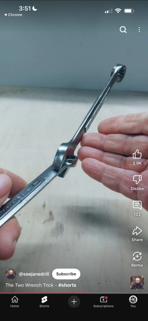

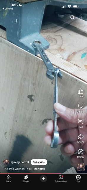

Finally got that little bastard (plug) off. Best way was by using the 2 wrench method. Piece of cake :cool:
