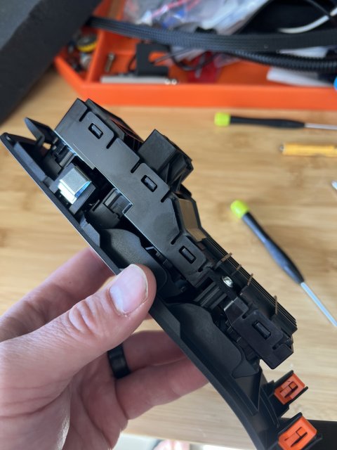

The driver door switches pop off with just a couple clips. Tried cleaning out the connectors. No joy.
Popped apart the switch back to see how it worked. I used a series of flathead screwdrivers to pry and hold each clip to get the rear cover off that had the plug connector on it.
The rear window switches are controlled by longer black arms, and the front switches by the gray shorter arms. When you toggle a switch, it pulls those arms in, then releases them. This is the mechanical operation of the switches. The next part goes over how the switch turns those mechanical operations into electrical ones.

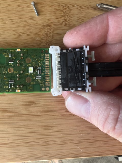

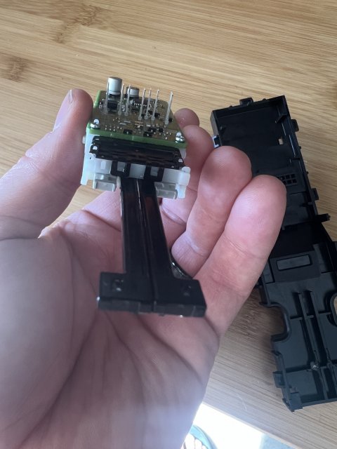

I took apart the white box (w/ black bottom) that was housing the mechanical mechanism that was being actuated by the switch movement. It's held onto the circuit boar by 2 Phillips screws.
Exploded view once you open the box:

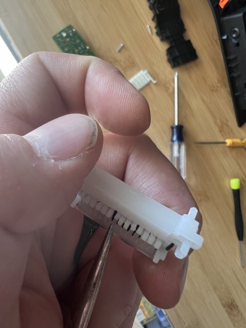

The long black arms were rolling over small little white plastic levers (Seen above, they look like the mechanism behind piano keys) that had a small amount of tension on them. When you move the window "open" or "closed" via a switch, it puts the white plastic piano looking levers into a detent on whichever arm is being moved by the switch (long black, short gray, etc), which then makes the white plastic levers push down on a metal connector that sits below it. That movement makes it touch, or not touch, the circuit board contacts, telling it to "open" or "close" the window. That’s the basic function. (I have a small amount of circuitry board knowledge, but a large amount of mechanical knowledge. So, sorry if that was confusing).

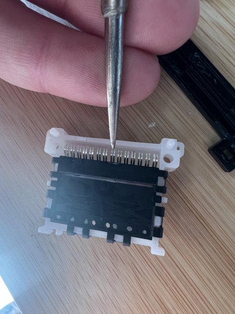

I found the white plastic lever, and accompanying metal connector that operates the rear passenger window. Pointing here (if your bad window is a different window, just follow which levers are being pushed down when you rock back and fourth the appropriate black or gray arm:
The associated metal connector that the lever pushes down:

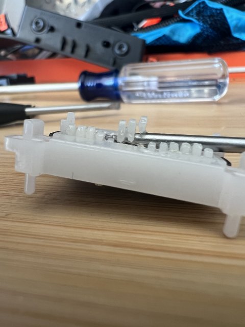

The white lever for the rear passenger window was clearly pushed over to one side, and slightly down:
This meant the metal connector underneath it was in constant contact with the plate on the circuit board. Hence why every other window operation would make a relay noise (being told to open or close) and this one wouldn’t, because it was in constant contact with the circuit board telling it that it's "constantly pressing the window down switch". It even had a little darker mark on the circuit board contact, and the bottom side of the metal connector was brown tinged. So, I scraped off any burned looking material gently on both the metal connector, and circuit board, spread the di-electric grease evenly along the boards, and proceeded to bend back the white lever straight.
But, it had too much tension down still, and wanted to make the connector still be pushed down, even at the standard position. So, I propped it up, and clipped off about 1-2mm of the white lever. This gave some breathing room to the metal connector underneath it. You can see that here. The farthest right white lever that's propped up is cut shorter:
