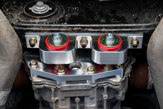

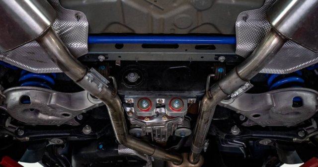

who's tried the new Steeda diff brace?

Hi, I purchased one haven’t received or installed it yet…. but I’m curious if you can check the diff level and drain/refill with the unit installed?

good point, seems like maybe not?
there's a hole for the lower drain, but would struggle to get a tool in there IMHO, and not sure how you'd get to the fill hole

It’s just a socket head plug…a ball end Allen wrench would slide right in there. But even if it didn’t is removing the rear part a real concern for the maybe 1 time someone would change the diff fluid? Let’s be honest…most people will never change it.

I’d be more concerned about accessing the fill port up top

Agreed. There’s very little room to access the fill plug, between it and the sub frame. A standard 3/8 ratchet won’t fit. What tool would you use to remove the fill plug?

Installed mine yesterday. Install went well except the upper/outer diff bolts were a PIA to tighten. My 13mm end wrench wouldn't fit the E-head bolt and it's too narrow for socket. Going to get a E-18 end wrench to finish tightening them. Otherwise it looks great and peace of mind is at hand! Steeda Brace.jpg
