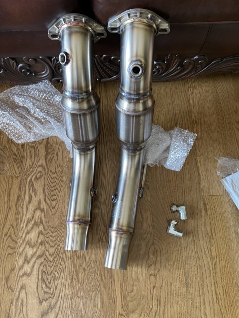

Are you throwing any codes due to the Fenfab cats? Did it come with defoulers or did you add them?

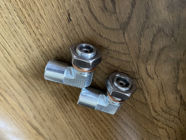

I have same setup as twin001, didn't run defoulers and didn't throw CEL. Have it tuned now, so indifferent. Agree with sound, it's awesome.

Who did and didn't run defoulers with the Fenfab downpipes, in general. Wondering if they are even needed?
I didn't but then they threw a code after about 150 miles. So now I do. I used the smallest orifice.

Just double checking the defoulers go into the ports on the downstream side of the cat , i.e. just before the mid-pipe connection?
1,506
Yes.
Yes

Defoulers are included, installed downstream of cats. Mine are in and have been for about a month with no CEL.
@F=MA you got the fancy flanges!!!
