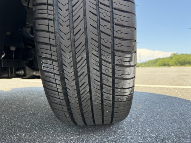

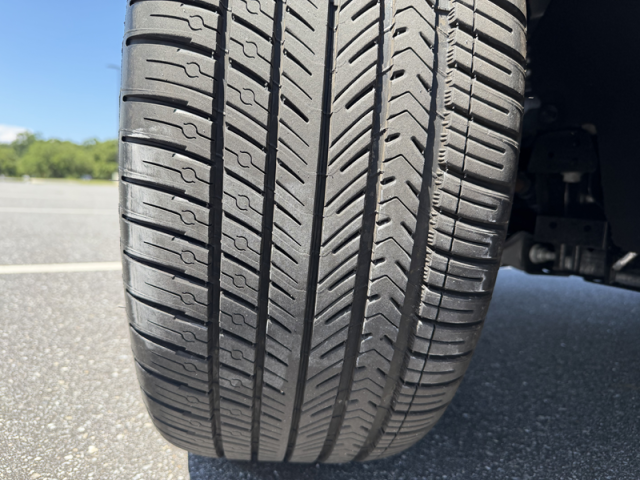

Finally chalked the tires today. Cold pressure is 32; these were about 34 psi because it's 94 right now lol. Went about 1/2 mile down the road to the high school parking lot. The first 150 feet were very consistent but still had chalk all the way across, so I went another 150 feet, and this was the result. I think I will leave them alone.
