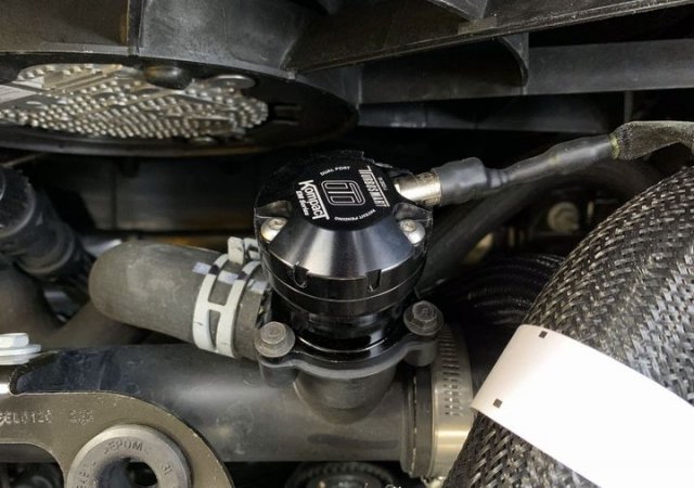

So I want to get one, Ta-0223-1066
is the one I though was needed but when you go to lethal and a few other sites, they have :TS-0223-1096 as the part number. Which one is the one I need?

TS-0223-1096 talked to Turbosmart and that’s the part number for our ride they recommend.

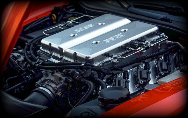

I may have confused you with my response.....it is irrelevant in my particular application. I'm very well versed in high horsepower and forced induction applications. The swooshy sounds are minimal and I much prefer the whine of a supercharger. :cool:

Looking at the 2 Turbosmart BOVs available, is the only difference between the 1096 Dual Port and the 1296 Plumb Back that one gives whooshy angry snail noises and one is silent? Is there any performance or reliability advantage to one over the other?
you got it. noise vs no noise. you CAN faintly hear the plumb back though--its not 100% silent.

In my case? Only the noise lol. It’s not nearly as loud as the bypass adapter, it’s just loud enough to make me smile when going past a tuner guy lol

The TS-0223-1066 is the one I have in my 2021 ST.

i just did the recirc version. sounds a tad louder. still nice for daily driving. i seemed to get an MPG boost. i think my stock one was leaking. if you want to see step by step instructions go ahead and see the post i just made with the install video in it.
