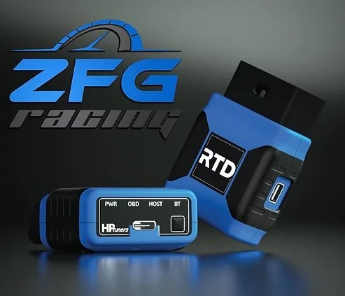

Also just loaded the ZFG Racing 93 tune this evening......OMG. Very impressed. :cool:

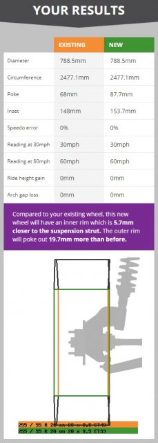

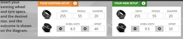

RTR Tech 5 wheels 20x9.5 +33 offset. Got them from: https://www.bbwheelsonline.com/rtr-...5x4-5-5x114-3-gloss-black-33mm-851GB-2096533/
Available in gloss black or charcoal. You'd want to run a 294x45x20 inch tire to get you close to stock overall height for speedometer consistency (0.96%). Hope this helps.
It does. Actually more than I asked for so I really appreciate it. Hers has the 20" tires already. Would they work temporarily work or would I need to replace the tires too?

The minimum tire width recommended for a 9.5" wheel is 245. Your factory 255 will fit fine (may look slightly stretched compared to stock setup). See the pics attached for before and after specs with a new wheel setup. Clearances are all good and the wheel will only be 0.22" closer to the strut and the wheel will be sitting 0.78" closer to being flush (pushed out).

Once again, Thanks. I'm sold and if it was my daily driver then it would be no question. It's hers and she doesn't spend it quite like I do. The rim website is saved as a favorite and the tire of chose is the Continental ExtremeContact. Those tires are around 330.00 each so I may need to ride the originals for a little bit. I want the setup more flush and the spacers that UNBROKEN turned me onto are close but the wheels are going to put ME where I want to be, but again the ST is hers.
