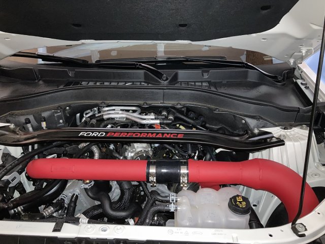

Well.... THIS was a 5-hour long PITA... looks nice tho.
652
Is that the FenFab unit? Has it thrown any codes?
Yup. A Gen 1. I preferred the look/style to his Gen 2 revision. Nope, no codes, he included the fix with the intake. The fix is a simple t-connection to three different air lines no biggie. I actually got this installed on Friday and have put a few hundred miles on it over the weekend. All is good so far. Sounds really nice too--alot more intake noise.

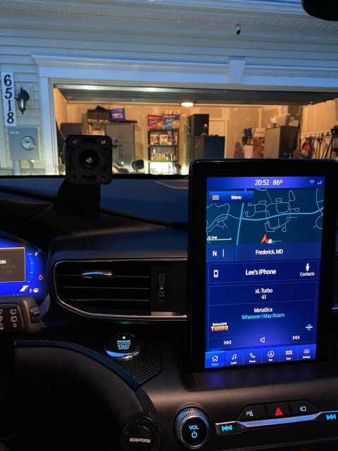

Attached a Pro-Fit mount to the dash. Screws in behind the vents. Will place my Rokform mount onto it, we’ll see.
I would be interested to seeing the final result. I like this mount that I just ordered one. Now need to figure out what to attach to it.
I added a Rokform Qi charger as I have a Rokform case. What I didn’t like was how the Rokform mount attached to another Rokform mount, which made it stick out too far. So I dremeled off the back and double sided taped it to the Pro-Fit mount. I’ll have to take a photo once my wife gets home. But this is when I installed it.
Gotcha. I bought the mount, and then the proclip mount so I can have car play available whenever I dock in. I’ll post pictures once’s done. Just happy I don’t have to drill into anything.
You have to screw the mount into the dash, as this one doesn’t use any existing screws. However, if you remove, at least there will be no visible holes. I moved mine slightly further to the left instead of using where they had it.

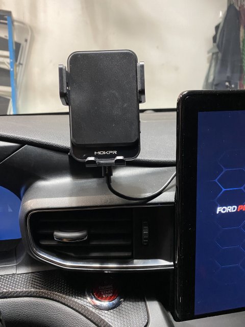

The proclip holster mount is pretty nice. I bought a Carlinkit wireless carplay recently so went with an auto-clamping Qi wireless charger mount. Most of the car mounts use a 17mm ball joint so like Staggie, I drilled out the AMPS ball joint on the Pro-Fit. Then attached a 17mm ball joint for the charger mount. Have a USB-C cord go down behind the screen, inside the center stack and back into the car charger cubby.

The proclip holster mount is pretty nice. I bought a Carlinkit wireless carplay recently so went with a Qi wireless charger mount. Most of the car mounts use a 17mm ball joint so like Staggie, I drilled out the AMPS ball joint on the Pro-Fit and attached a 17mm ball joint.
I am curious on what the end result looks like. I may need to go that route perhaps as well.

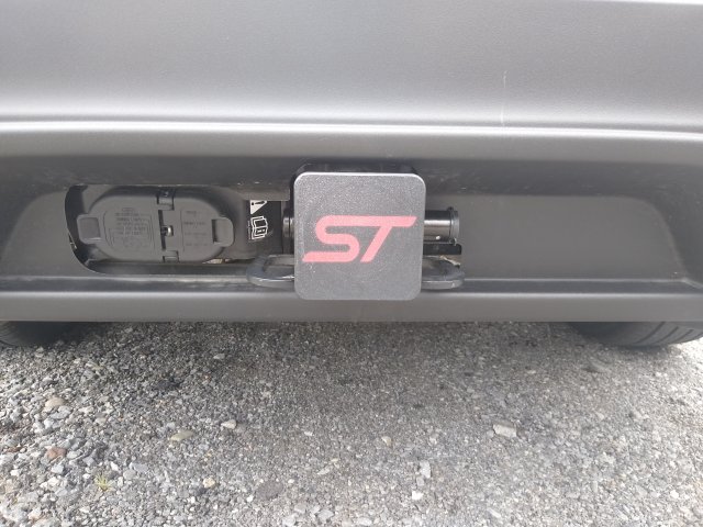

Installed the S/T hitch cover today! That along with the floor liners, window tint, and lug nut covers from a few weeks ago has reduced my 0-60 time by 0.0004 seconds!
View attachment 7471 View attachment 7473
Awesome! Thanks for the pictures, I was wondering the best way to route the usb cable. Thanks for sharing that information.
When you’re installing the mount, you have to take out the head unit screen bolts. If you remove the screen, you have access to run a usb cable into the center console cubby. You’ll have to drill a small hole in the top and a small one in the cover at the top. In the event you want to get rid of the cable, you’re only buying a cheap cover to replace the one you drilled.
