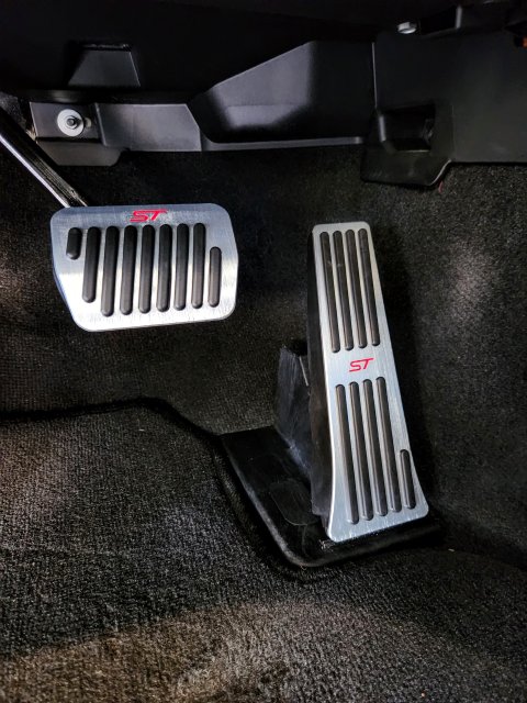

While not a fan of folks accessorizing the interiors of their rides like a Filipino taxi, I took a chance on these pedal covers. I was surprised at the quality and fitment for the money. I think they nicely enhance the cockpit of this performance vehicle.
https://www.amazon.com/Hecotrax-Explorer-Performance-Accelerator-Accessories/dp/B08MT5MC4W
Have the same. I found the brake pedal needed some heat to get the flap properly installed. Mine have held up great so far. UNBROKEN probably has 100k on his and I think they are good to go.

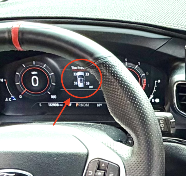

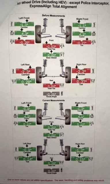

Alignment done at Ford after Eibach springs.
2,062
1,441
Yup, looks good. The dealer I bought my ST from could not get my alignment done after springs. They had no clue about the rear upper inner bolt. Any the ST’s had been out for two years when I bought mine

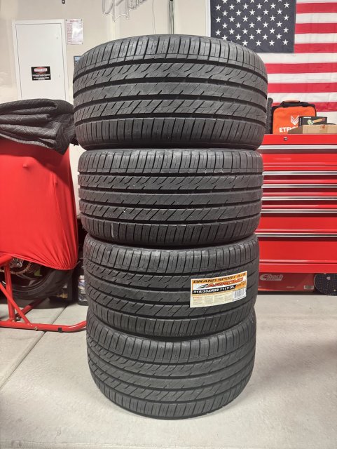

My, my, those are some huge meats. Beware of Vette owners lurking around your garage in the wee hours of the morning.

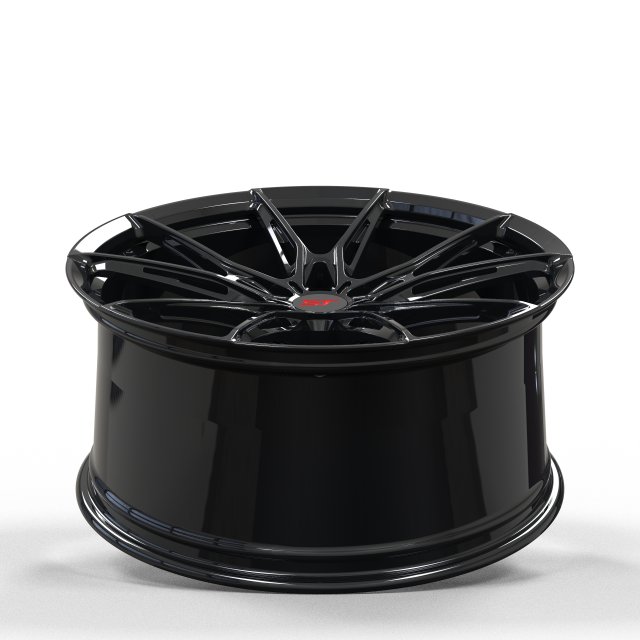

What sort of offset is needed to make those fit with no rubbing? What wheels are you planning to get (or have gotten)?
Your ST is going to look mighty fine with the new socks and shoes.
274
132
2025 ST
SugarMouth,
22x10.5 +30 Rolling the dice on Alibaba. Maybe here toward the end of the month.

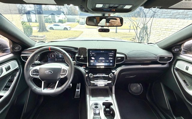

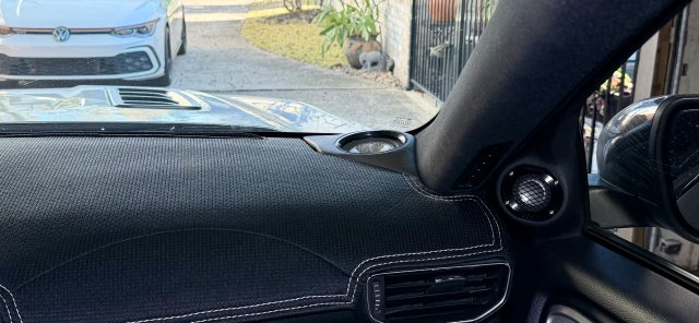

Did some fine tuning on the dash midrange install. Last step will be having the dash mat hemmed where in had to cut it around the pods. This project is 99% done. IMG_9495.jpeg
The pods actually overlay the pillars to push the drivers out as far as possible. Laser scanning and 3D printing in the hands of an expert yields some cool results. IMG_9484.jpeg

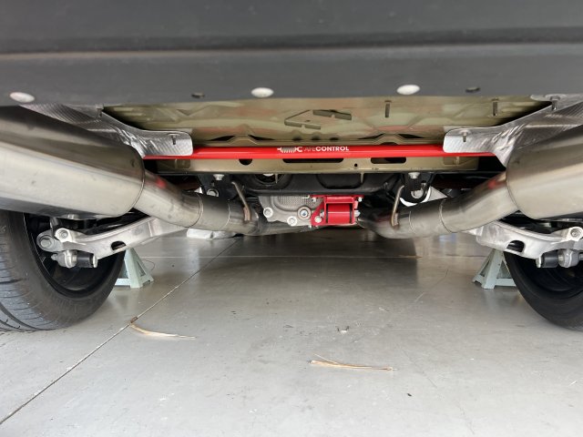

Installed the AWR brace that I bought from a member . That 3 o’clock diff bolt is a PIA putting back in with the brace.

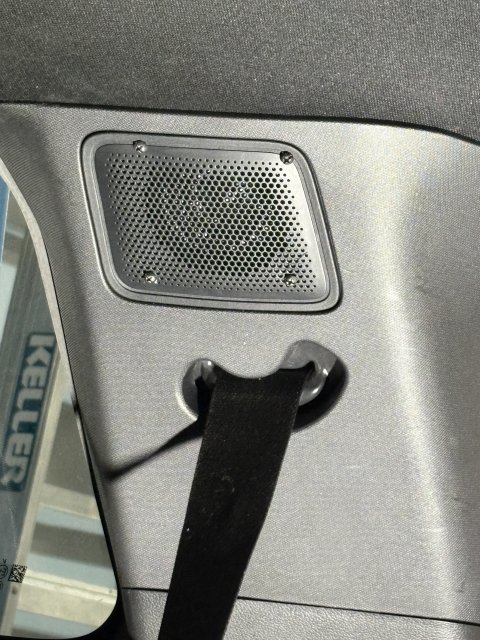

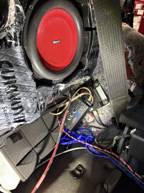

Not necessarily today, more like the last week…new amps and speakers.

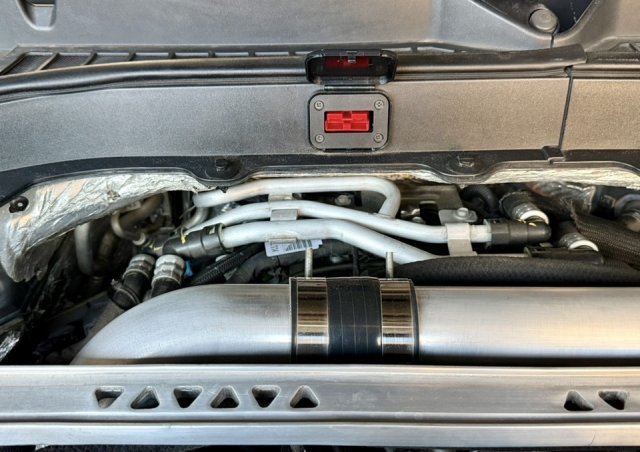

Added an Anderson SB50 connector under the hood for easier access to plug in my power supply at audio competitions. Not my first choice of locations but I was limited by the size of the flush mount cover. IMG_9595.jpeg
