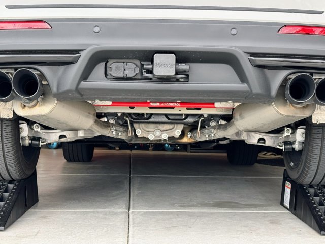

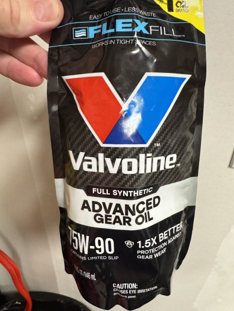

Dumped the factory rear diff fluid at 3600 miles.

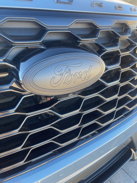

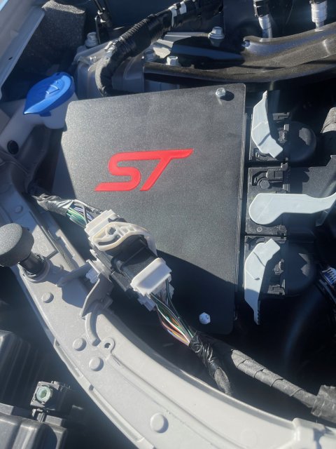

Let's see; Got the windows tinted, finished my 3D printed ECU cover and blacked out the front FORD emblem.

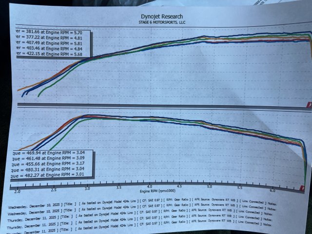

Had a local shop install FenFab downpipes and CV Fab intercooler with the hot and cold side pipes. They dynoed before and after, surprisingly, i picked up 40hp.

Damn Son, that's actually impressive.

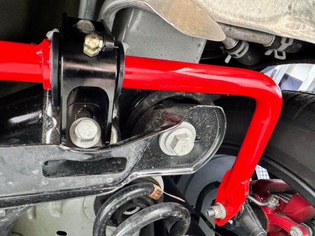

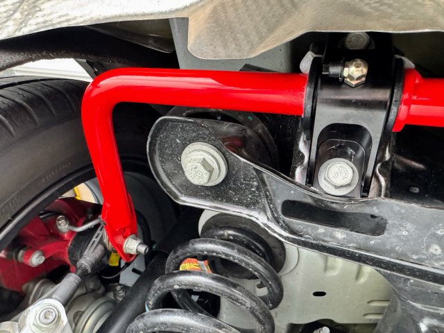

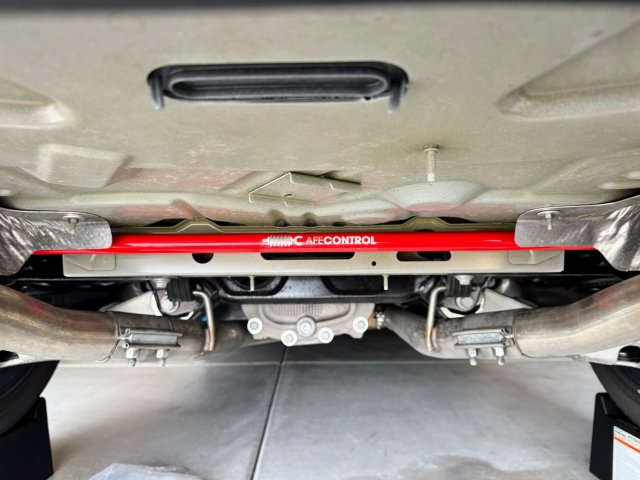

With the Thermal exhaust you do not need to lower it. Just loosen the heat shields, don't remove them and work around them. After the first drive get back under and remove the extra grease that spread out from the bushings.

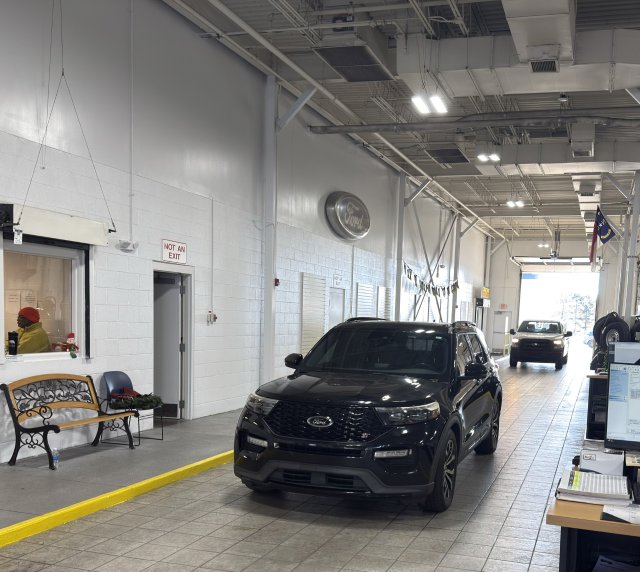

Took care of some recalls. The one driver passenger seat track part has 3 motors not 2 that they originally thought so they ordered the correct one. Which is fine I still need to get the drive side panel that has been upgraded.
