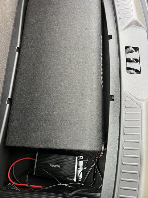

Also added a kicker key500.1 and 12 in sub to the storage compartment.

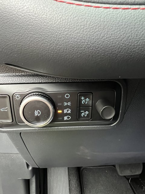

Last project was add a flush mount bass knob to the headlight controller. Simple mod and I did this to my Bronco too.

Details man, I need details. How did you route it to your sound system? Did you have to buy any special add on's. What model sub, etc.......... Details man! Thanks!!!

Amp was from Plug and Play kits with the speaker level wiring harness inputs going to the DSP kicker key. Plugs right in between the factory amp (and head unit?) and provides remote turn on for the 500.1 so just need to run power. The ground is close by under the trim covering the hatch. Only need to remove the trim on the rear hatch and driver side 3rd row cup holder to access the factory amp and run ground and harness wires. Haven’t calibrated the DSP on the 500.1 it yet, but I’m rarely above 15 volume level. But it booms with the kicker 48TRTP122 box. I ordered a second kicker 12” box with a less powerful Kicker Comp 4ohm box just to see if it would be louder than the passive radiator one. Haven’t tried the 4ohm one yet. Both were on sale for Cyber Monday but are $40+ more now.
Ran the 8guage power wire from the passenger side through a grommet just under the airbox. Was a pain to get it run to it and barely had enough wire to run from the battery to the trunk on the driver side. Don’t think I’ll run a bigger amp, so this works.

Oh - and flush mount bass knob was run on the driver’s side away from power. You can disassemble the knob by turning it all the way “on” and then pull the knob off. It’s held into the kicker housing by a washer and 10mm nut. Loosen those and the circuitry slides out. Drill a big enough hole for just the knob to go though the light switch, replace the washer / nut and then the knob and you’re golden.
