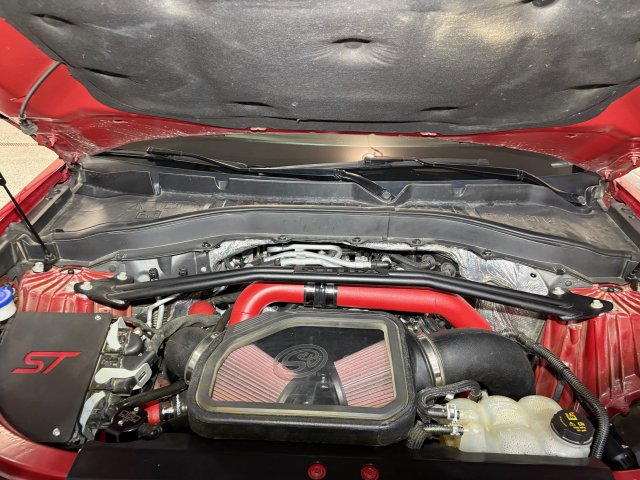

Got my FenFab pipes installed... opted to swap out the non-BOV cold side for one with the HKS simply as an abundance of caution. Hoping I can't hear it in the vehicle.

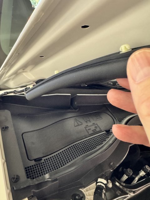

Missing rubber installed. Plastic liners under to follow. Part # LB5Z*16A238*A

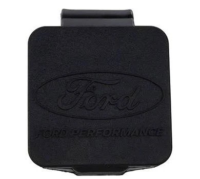

I added a standard FP hitch cover. I wasn't impressed with some of the 3D-printed options on Amazon; the red didn't match, and the way they clip in would likely cause rattling. The more stylish ones cost $400 to $500, which seems overpriced, especially since I just bought a new range for $1,500. I'll stick with the tried-and-true boring option; it works just fine. FP.jpg

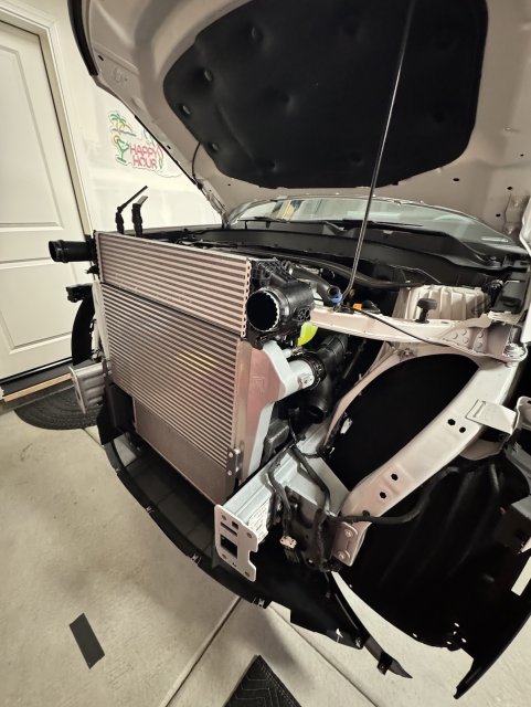

Today was a big day, I did some playing around last week to so I’ll add that one in. Last week was CVF intercooler, this week was CVF downpipes and a retune from Matt at Gearhead. Downpipes… proud of myself for this one, I did them with weight on the ground all 4 corners, fronts on ramps, did not drop the subframe! Driver side took all of 30 minutes, passenger side not so much, but removing the heat sheild made it easier I think, and getting the car hot helpped to. You can clearly see the nut you need if you peek at just the right angle through the wheel liner, I put a hand dandy headlamp on the subframe pointing at the nut, once I could see what I was doing, it was cake. Props to Matt at GH, he’s tuned my explorer from the beginning, and I’ve been impressed from the beginning! Those of you looking for something other than ZFG he’s your man!

Added the sides under the rubber seal. These did require some modification to fit.
LB5Z-7802039-A
LB5Z-7802038-B

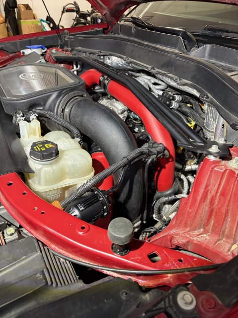

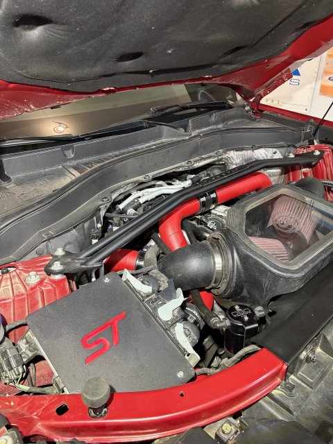

Catch can. I think the PCV valve line might be a bit too short—I barely managed to clip it in. I’m going to send them a photo and ask about it; maybe it was cut just a little short during manufacturing. Other than that, I’m curious to see what it looks like after a couple thousand miles. Nice piece of hardware, and it will be easy to unscrew and dump.
View attachment 32244 View attachment 32245 View attachment 32246
Yep the PCV was definitely a bit short, required me to fish it through the most efficient way. An additional inch of line would have helped. I think this is because the earlier models had less harness in the way than the late models and they have not updated the part.
Perfect, thanks. I tried going over the one line, but that wasn't happening (right by the PCV). So I went under and it barely made it lol. The only issue, is one day changing the PCV, but thats a few years away if then.

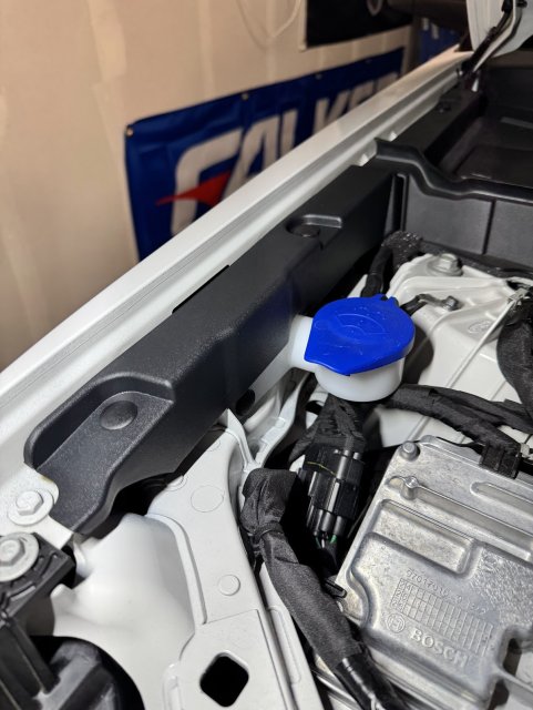

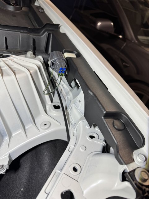

Did you have to swap the location of the coolant overflow and the wire harness here? On mine it was swapped and interfered with the can mount.
198
95
Mobile, Alabama
2025 Explorer ST 4WD
No, my photo is exactly how it was. I just made sure the bracket and the coolant line elbow have about a 1/8-1/4" gap, and then tightened the hell out of the frame bolt.

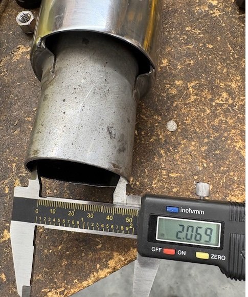

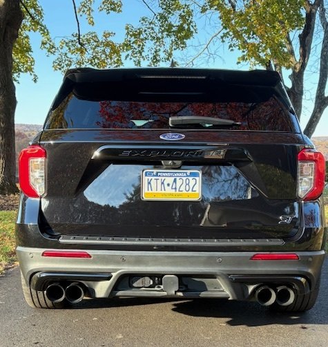

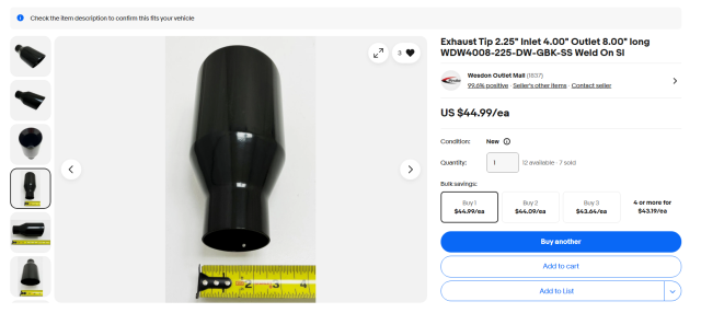

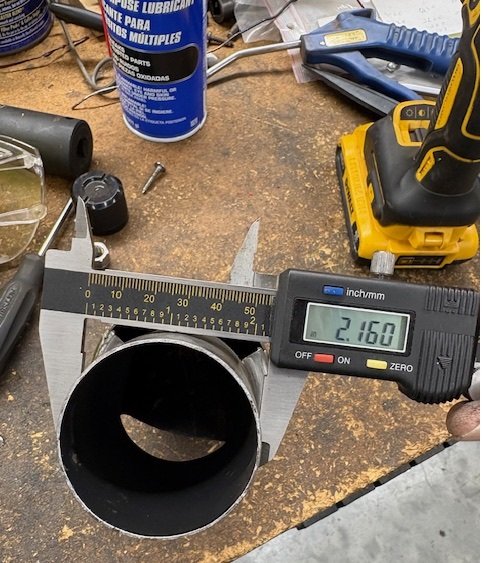

Put Wesdon tips on the stock exhaust, not really a plug and play install. Tips were 2.25 ID stock pipes are 2.16 OD. Cut 2 inch sections of 2.25 OD exhaust pipe and expanded one end to fit over the stock exhaust.
