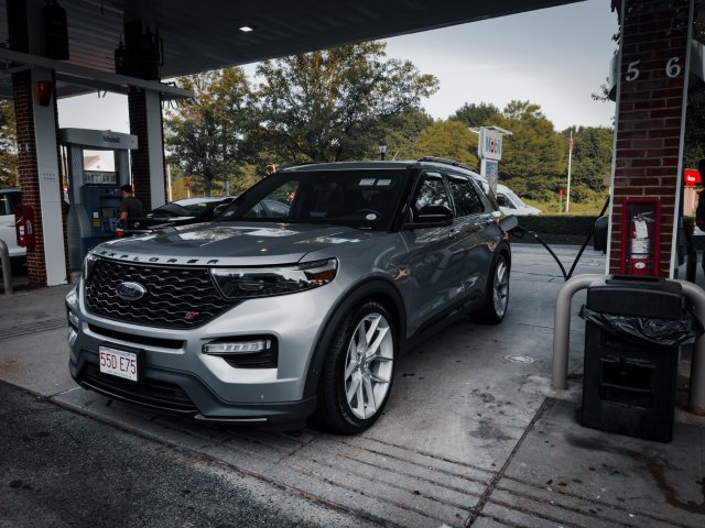

A few weeks ago I picked up a set of 22x10.5 Niche Prodigy 5 Wheels. I haven’t had time to get good pictures, but here a few pics from the cell. 577F2AF2-5124-429D-BF43-552D1CA0FA8F.jpeg IMG_4195.jpeg

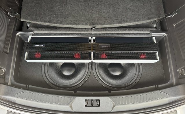

Finished the last little trim piece in the false floor fifteen build.

These look nice. Are these 22x9 with a +38mm offset? What size tire did you end up putting on?

Thanks! They’re 22x10.5 with 38mm offset. Tires are 285 40 22 And I’m lowered on eibach springs. Rides great with no rubbing at full lock forward and reverse.

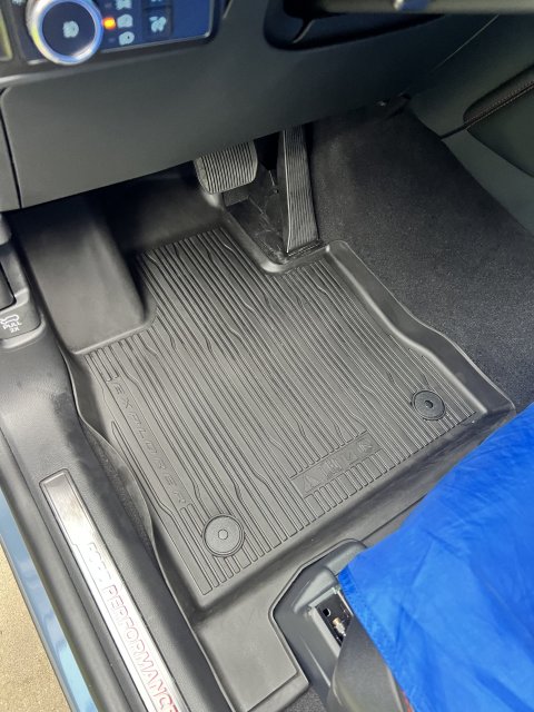

Got the Explorer mats used, got them home and scrubbed them down and cleaned them and installed. Nothing crazy, but it's the first thing Ive done to mine since buying it a couple weeks ago. Just wana track down the 3rd row mat and rear now.

If you bought it new, you should have Ford Pass points coming soon that can be used to buy the 3rd row mats from Ford.

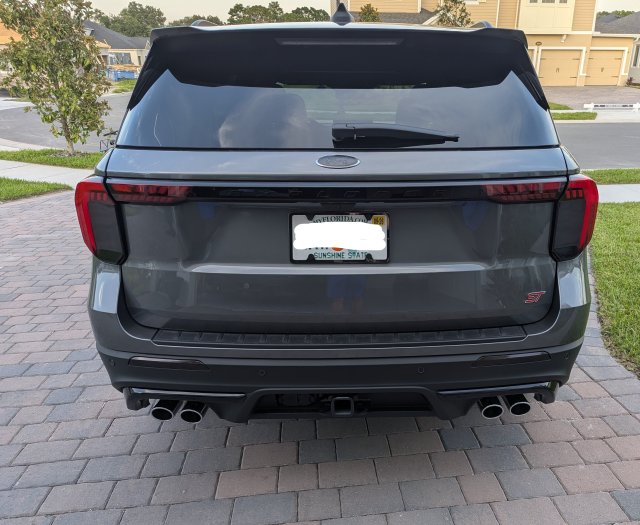

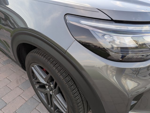

Added some lens tint. Not sure if I will keep the rear though, in certain light it looks too dark and will probably attract unwanted attention.

Looks great
I keep checking but nothing has showed up on the app yet. I picked it up July 10th so imma give it the 30 days and if still nothing ill call the dealer.

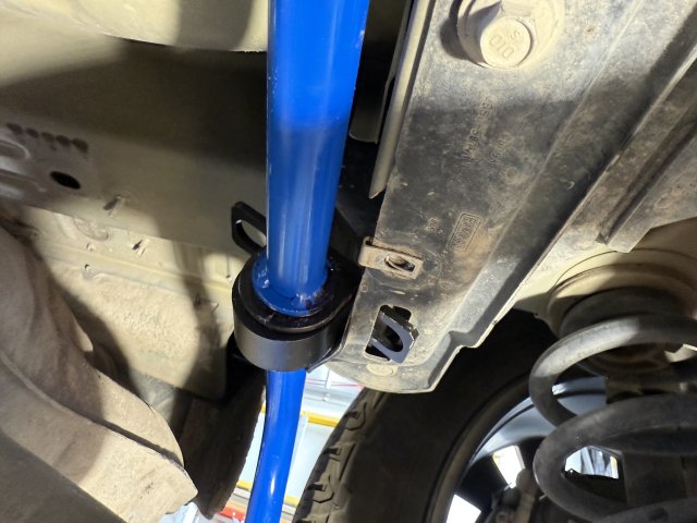

Installed Steeda Rear Sway bar. Amazing difference. Also discovered these handy slots to hold the bar brackets to make starting the bolts much easier.

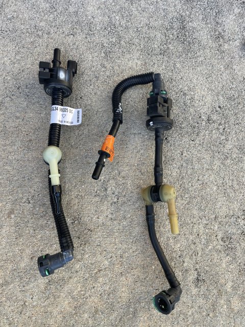

Swapped out a bad purge valve at 55k on a 2020. This thing is a PITA to swap. Little to no room but with a small 90* pick it can be done in about 30ish IMG_5209.jpeg mins.

Where did you get the lens tint, if I may ask?

I did the same and noticed a difference right away. While it took me an embarrassingly long time to install, I was pleased with the result. I did sand, primer, and paint the bar grey -- I did not want the blue peeking out of the fender well.

What exactly is the common issue with the purge valve on these?
On the Focus ST, they're known to go bad, and will cause a few CELs and worst case, the fuel tank can deform. There was a recall on it. Most people just replace them periodically as preventative maintenance. Some people have even gone so far as to DIY their own replacement that can correct the issue, and make future replacements easier.
I wouldn't be surprised if it was a substantially similar part. I wonder if a similar approach could be taken on the Explorer.

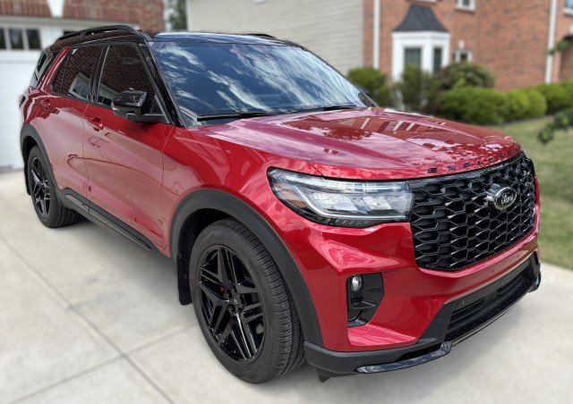

Today, I installed the ID-Speed (Custom Performance Engineering) Rear Differential Brace. I had a few hiccups in the install:
1) The furthest bolt on the passenger side would not fit when the mount was in place. I put in a shorter socket-head cap screw.
2) The aluminum mount for the bushing brace had burrs that needed to be addressed. Afterwards, the angle of the brace coupled with the insertion of the 90mm socket-head cap screw made it less that a straightforward process. I was able to get everything together without cross threading anything.
3) There is no room for a socket on the two bolts on the passenger side; expected the one replaced with the cap screw but not the other. Elbow will try to click at 25ft-lbs.
Mine is a 2025 ST 4WD - based on the forum knowledge, it is a block 1.

Fairly tame set of upgrades given this crowd. I did not change wheels, apart from color, since I need to be able to travel in snow and some forest service roads. Engine performance enhancements are bounded by the need to tow motorcycles and other things on occasion. I did not do a new intercooler, down-pipe, or other modifications due to either cost or lack of perceived need. I may consider those during the life of the truck as other maintenance occurs.

They stick open and cause cel p0496 to pop up. Upon filling up the tank, it can cause the car to not want to start. It happened once to me after the cel came on and I filled up a few days later. It took me to tries to get the car to turn over. I knew that it needed to be replaced asap as I’m at the gas station every other week. It isn’t as easy to change as the focus ones but can be done in about 30-45 mins with only a 10mm socket, flathead screwdriver, and small pick.
