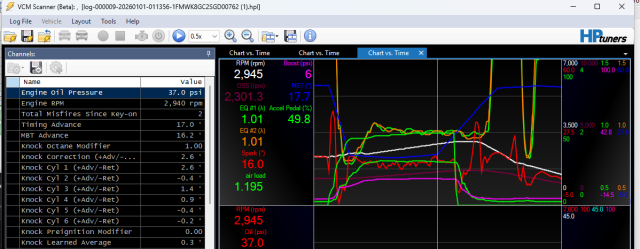

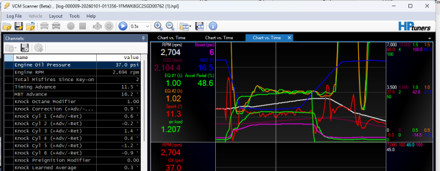

So here is the log, you can see were are logging all 6 cylinders for knock and the overall average as it's using average mode at this RPM. You can see KOM is 1.0. Spark is 15 to 16 degrees. the over knock correction is 2.6* meaning it's adding timing over the borderline base and each cylinder is either adding or subtracting to create the average. The ecu is Constantly doing this trying to keep the spark on the borderline of knock. I dug into the knock sensor thresholds and it looks like the nock sensor noise ( threshold for the background Nosie not the nock threshold) thresholds are higher on the 2025 which might explain why it's not registering the knock as it thinks it just background noise. SO lets try this I'm sending you a revision with those thresholds for noise lower. Also please log the stock tune under the same conditions I'll show that here as well.
