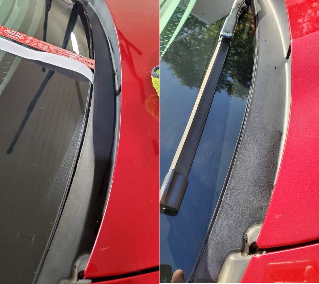

Ditto the last three above me, Windshield leak before and after trim corrected.jpg

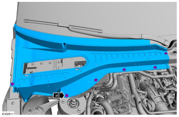

This is a DESIGN issue that will require regular maintenance cleaning. The issue is a BLOCKED drain relief bladder behind the wheel well splash shield. Plant debris lands on the front window cowl and makes its way BEHIND the splash shield and clogs everything up. This probably applies to all of the SIXTH gen Explorers.
Please read this thread below.
