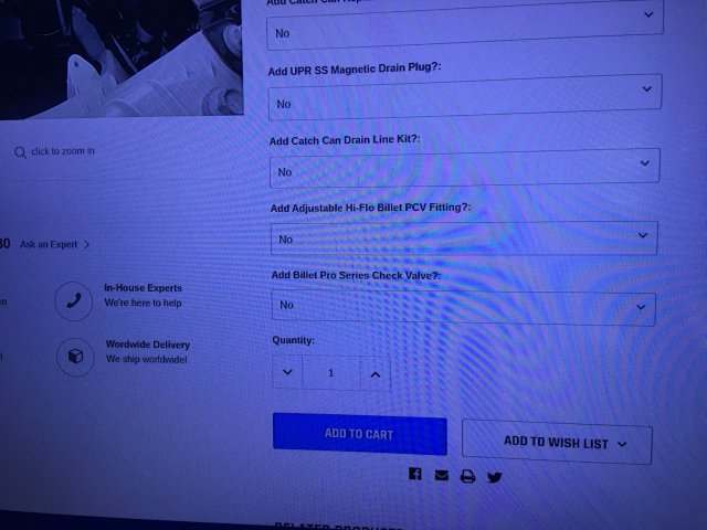

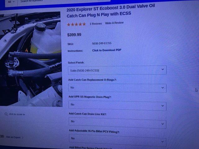

So can anybody give a summary of the part numbers they ordered from UPR to complete the install of the catch can for the 2020 Explorer ST. There are various options and I do not want to come up short a necessary part. Do not know if I need an adjustable pvc valve or the optional check valve, etc.
5,356
6,410
Thread Starter #25
You don’t need any of the optional parts unless you just want them. The basic kit comes with everything you need.
