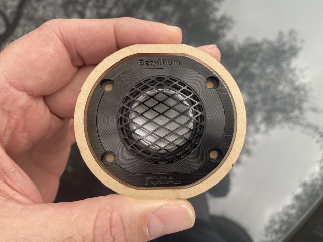

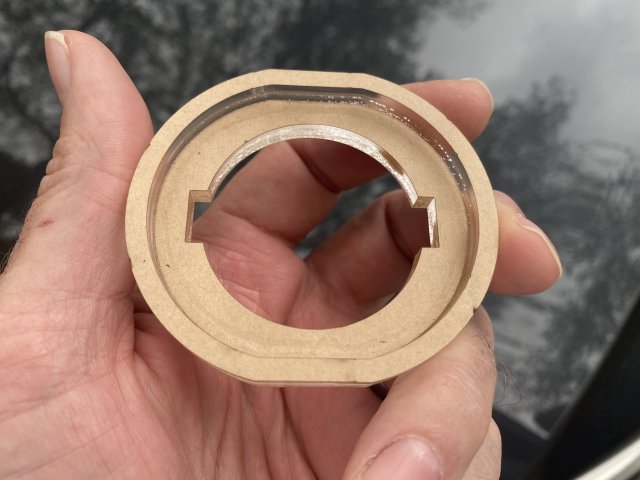

Flush mount acrylic cups we made today…time to cut up the sail panels.

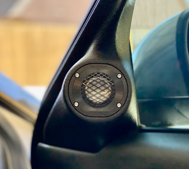

All of the details are in my stereo build log but here’s the finished product or the rebuild over the last few months. 4779D074-A3B6-4160-8591-A8C37D653A22.jpeg BD23CE39-B855-494F-A1AB-6BC4CFE2E699.jpeg

Really clean and professional looking!

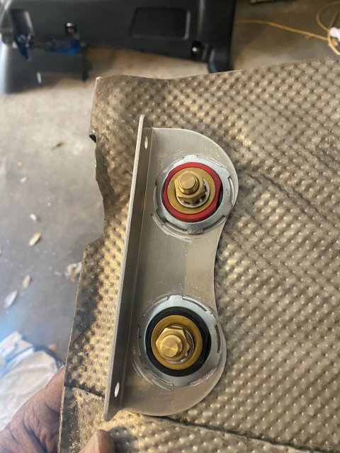

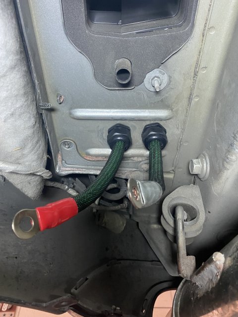

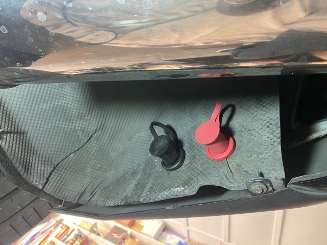

I wanted external charging posts since the battery is buried under that panel under the hood. This will give easy access for a charger…mostly for long stereo tuning sessions on the car but I guess they’ll save me if the battery goes dead too since I have no locks in the doors. The piece they’re mounted to is thin aluminum so I used a mounting plate for a backer to stiffen it up.

Where exactly did you mount that? I haven't looked but don't they give you at least an accessible positive terminal for jumping?
I usually run a pigtail for a battery charger but nothing heavy gauge. I like the idea of a high current easily accessed charging point.
There’s access but I wanted better access. lol
I also wanted a way to charge if the battery is dead….ain’t go no key hole. lol 1EDBCFE4-22A7-4141-9B48-435711222519.jpeg
I also wanted a way to charge if the battery is dead….ain’t go no key hole. lol View attachment 11260
Ah I see.
My wife's Mercedes has an Aux battery under the seat in back. If it dies, you have no gears as it drives the transmission selector motor so you can't even put it in neutral.

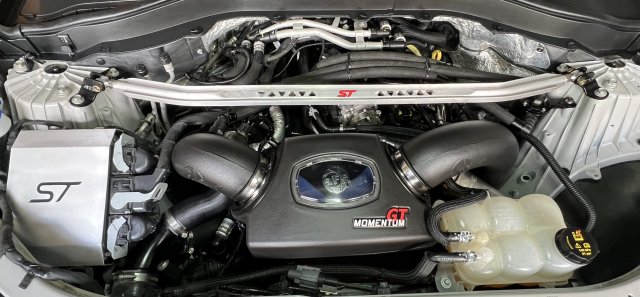

I had the aFe intake sitting in my office since March…figured I’d get off my ass and throw it in this morning. 141E8614-994C-4502-945B-1E07505926CA.jpeg
