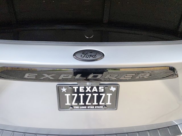

Rear wiper delete completed and I love it. After I pulled it apart I started looking for a rubber plug to stick in the hole...then I went down a rabbit hole on Google images and discovered a part I’ve never heard of in my life. A billet wiper delete plug. Who knew? lol
They all looked similar so I grabbed one for an import car. Dimensionally it’s perfect but there’s one little raised part on the back side that keeps it from sitting flush. Literally 20 seconds with a Dremel and that little bump was gone and it dropped right in place. I did have to trim some butyl away inside the glass to make the inner piece fit right But that’s no big deal.

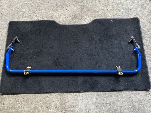

Steeda has a 1 1/8” rear sway bar out now...got mine ordered today.
Ordered! Thanks for posting... Hopefully I get it before everyone else jumps on it and they get backordered

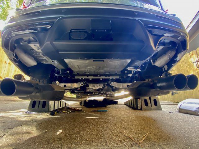

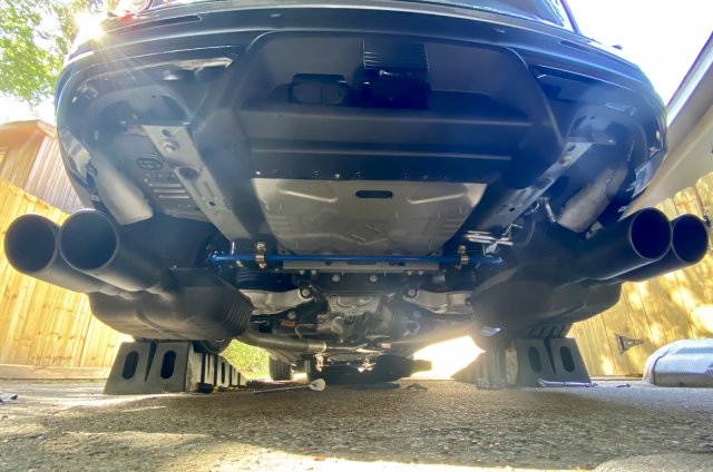

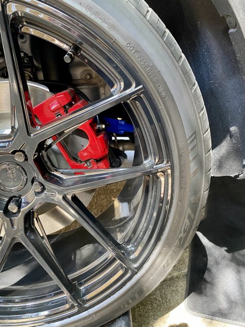

Crappy pics but I got the Steeda rear bar installed. D2EA9E81-9ABE-4C60-9D6C-6C5DF838967E.jpeg 67D08D7B-EEFC-4A05-B8B0-2E5EAFDF9C72.jpeg D2F48611-FA33-490A-A05C-5EFEF6AF103D.jpeg 754F18D2-6B95-47CA-9E78-A62848919EC9.jpeg

Nice !! Love that the color pops thru the wheels.
