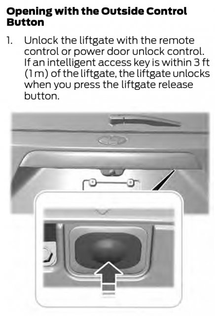

Yes, the key fob is in the pocket. But good to check all the boxes first.
I didn’t buy the foot sensor add-on. And my tailgate does not open when locked. Might be (yet another) gremlin in the vehicle. 484F1BBC-B263-4620-BCAF-3FDFCCF51189.jpeg
UPDATE: Yup, you’re right. Found the part where it’s supposed to be working. Thanks.
